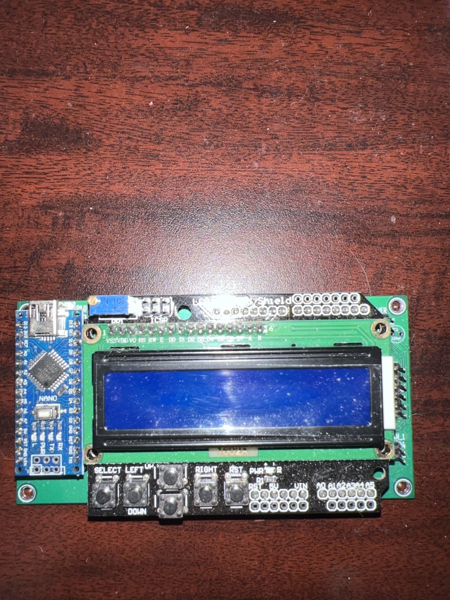

I have this one that I never ended up using
