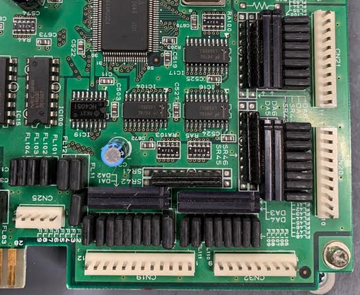

I had one member with the STV IO board have alignment issues with CN25. It seems there is a revision of the STV that slightly shifted the CN25.
Please send me a PM when you receive your IO board and let me know how the fit is. It should be a simple change to the board design, but I'll work out a solution for those with issues.
Edit: At first glance it appears boards with the stock IO board installed have slightly different measurements. This is probably why I didn't catch the difference. If someone knows more about the revisions let me know. Pics below. I'll probably redesign the IO board to accommodate both layouts once I get some accurate measurements. Anyone near CT with the incompatible layout? For those that have the incompatible layout, it should still work if you're careful, I'll provide replacements once I have them printed.
Compatible layout:
Incompatible layout:
Got my board today and checked against both of my STV mobos. Both have the factory IO boards and both match the incompatible layout exactly. It's close, but looks like it will be a pin or two off on CN25 if I use CN21 as the main point.
If there's anything I can capture off of my mobo to help you, just let me know.
I appreciate the offer! I will let you know. I should have an STV board with the factory IO coming in the next week or so. Once I have the board it should be pretty quick to resolve.
My priority is getting new boards to anyone who has this variant and confirm the fit ASAP.

Also I have that incompatible layout. Sending a PM @everten.
