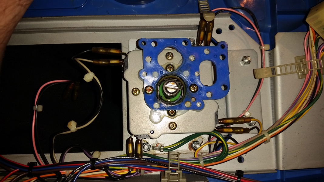

The Sticks don't actually mount to the panel but rather a sub bracket that's bolted to the top plastic of the panel from the under side. These cabs use Seimitsu LS-32 sticks with separate push on connectors for each switch. Also interesting is that the 2L8B panel used round gates while the 2L12B used square gates.

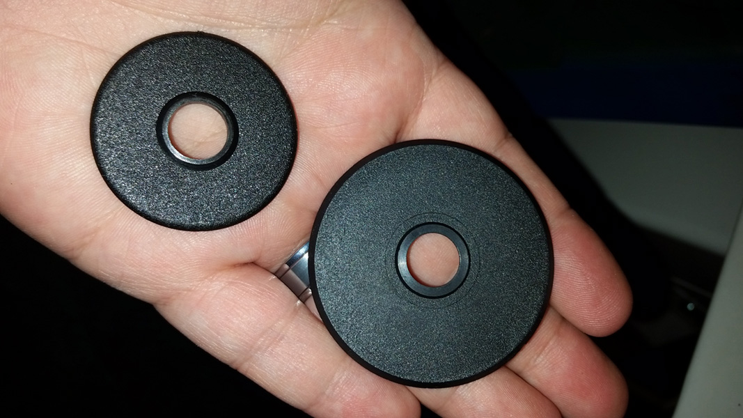

also interesting is that the panel uses just 1 dust washer mounted BELOW the panel, and it's over sized. here's a comparison of the oversized E29 dust washers compaired to the new ones from Seimitsu

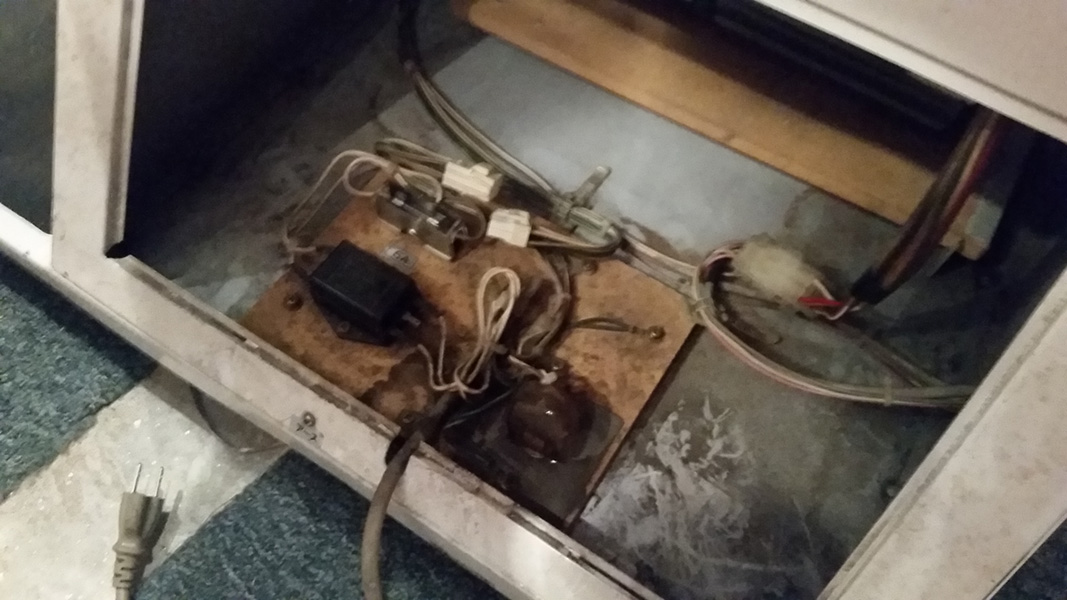

During this time I did some work on the internals as well. the AC block was filthy, and some savage had ripped the ground pin off wall plug.
This part was actually REALLY well designed, 2 Philips bolts and 1 connector and the whole thing can be removed from the cab. This allowed me to easily remove all the parts clean everything up and reassemble. I really hate replacing just the connector on the end of plugs so I replaced the whole power cable. I found a 15ft white 16ga extension cable at home depot, cut the female end off and crimped it to the AC block using the same style crimp connects that were on there originally.
Some minor surface rust inside the cab and some staining on the MDF that I couldn't really "clean" but overall it's much improved.

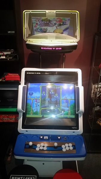

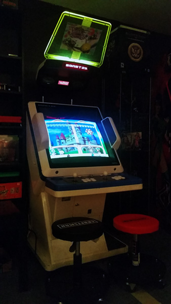

So Now you're pretty much up to speed on how this cab sits now here are some overall shots:
Also Just last Weekend @jassin000 hooked me up with some brand new Taito Stools to really complete the package:

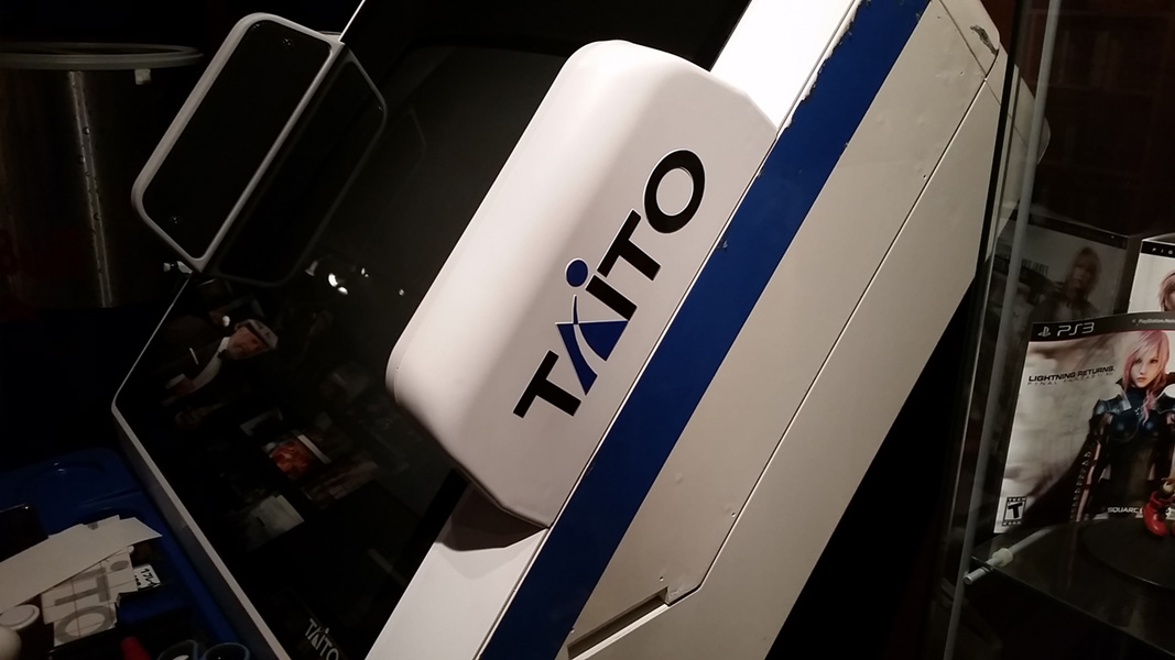

I've got a cutting machine so I've been able to cut some vinyl for the taito logos on the speaker backs.
The production model didn't have this but it was in some of the prototype images. I'm really happy with the result:
before:
AFTER:
