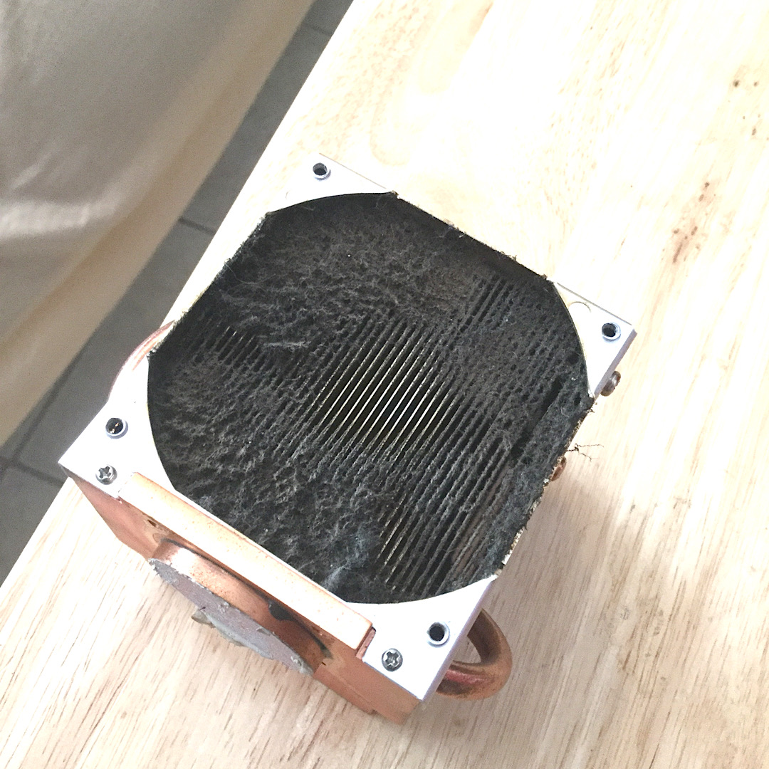

Got my replacement cpu fan for the Taito x2. Holy crap the heatsink on this thing is awful. Probably most of my noise problem is right here. We will see once I clean this and put the new fan in. Unfortunately I just have this fan so far. I plan on replacing the big ass case fan and the two little psu fans and the graphics card fan too.

Well shit this thing is still really loud. I now think the main culprit is those little psu fans. I’ll report back once I get the replacements. Oh also some notes for anyone doing this. The cpu heatsink is attached using a bracket in the back, so if you take it off that bracket comes loose and you have to take off the motherboard to get it back on. Not a huge deal but a little of an annoyance. Also that fan recommended for the cpu heatsink needs longer screws to attach like the stock one does. That or you can enlarge the holes a bit so the screw heads will go down into the plastic some. The Noctua case fan I got was an easy swap since you can reuse the metal bracket and the fan shield. The quest for a quiet cabinet continues.
Finally got my psu fans and replaced them. Still had pretty bad noise and I figured out it was the huge case fan. I replaced with a noctua but the Taito x2 pushes it full capacity and I think it was vibrating the case and sounded awful. I tried the low noise adapter that came with some other noctua fan and bingo! The thing is finally fairly quiet and in the cab I doubt I’ll hear it at all.

For the x2 or the vewlix? Some vewlix cabs have 60mm back fans and others have 120mm and maybe others have something else. So measure what is in the back of the cab. there are good replacements for 60mm and 120mm. Vewlix with the original monitor have monitor fans and those can be a pain to replace, but mine were quiet so I didn’t bother. It was the 60mm fans that were stupid loud. You just have to take the backplate off to get to them so not bad at all. There are good replacements for all the x2 fans. The psu ones are kind of a pain to replace but the others are easy. I’m glad I did the x2 since it got me in the case cleaning it out. The cpu heatsink was really bad. Years of smoke on that thing.
