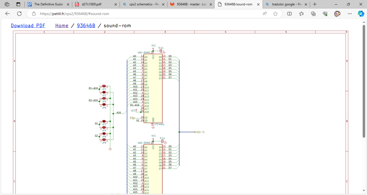

That is what I'm going by. The jumpers for the Sony CXK27C1001DQ-15 used in my COA are crossed as Jedec. The changes to your XLS show the jumpers differently than capcom used to achieve a working game.
I just want to make sure as I'm trouble shooting my issue I have the context correctly.

Uploaded XLS again, It was correct before. the cps2 schematics are wrong all jumpers are misplaced, confirmed with multimeter and a B-board.

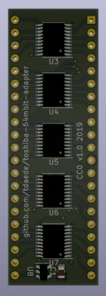

Hi. Anything for making work the famous 64mbits PCBs for MVS and SEGA Model on CPS2/ZN2 games?
https://github.com/tdaede/toshiba-64mbit-adapter
The final pinout is not exactly the same, as the A21 signal is in different place it seems
In the before mentioned systems, the pin 11 CE signal is out and in its place it goes A21 signal. But in CPS2/ZN2 doesn't work this way. Any info?
This is a really cool project, thank you for sharing it - I didn't know.
I did find this post; refers specifically to E and A21 being moved to their "correct for NeoGeo" position for 1.1
http://www.neo-geo.com/forums/index.php?threads/64mbit-8mb-flash-adapter-board.260677/post-4238025

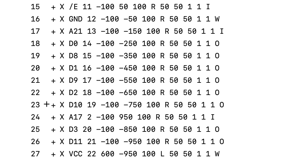

So if 'I'm reading the commit history correctly then 1.0 should have them in the "original for CPS2" position in 1.0
Initial commit here
https://github.com/tdaede/toshiba-64mbit-adapter/commit/2e3c332063b711b10d8ab1dc0b8d28ad09a71a6e
and A21 on pin 13 if I'm reading line 17 right
There are a couple of other changes from 1.0 to 1.1 as well, so this might not be a simple as just manufacturing the v1.0 boards for CPS2.
Can anyone confirm that I'm on the right track here?

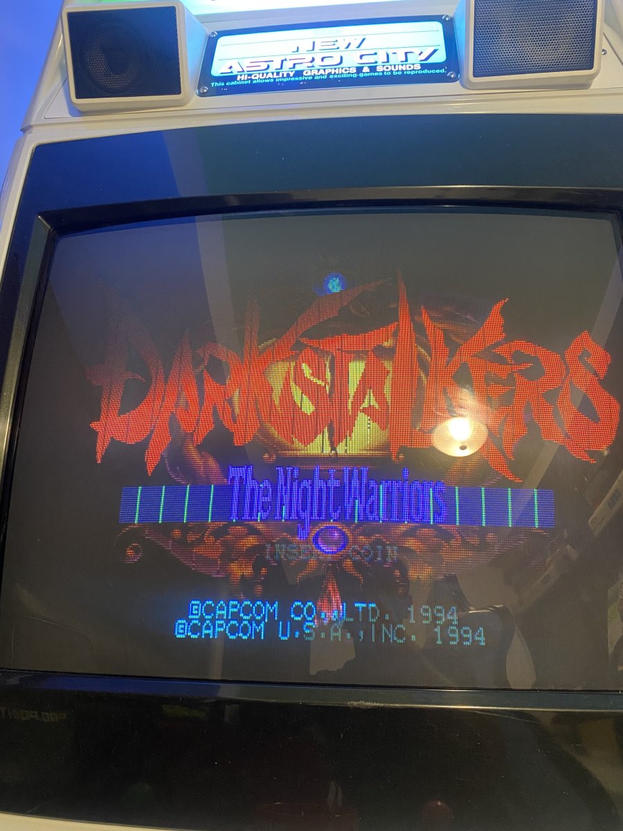

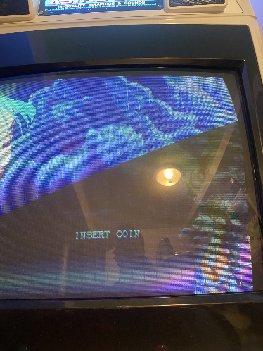

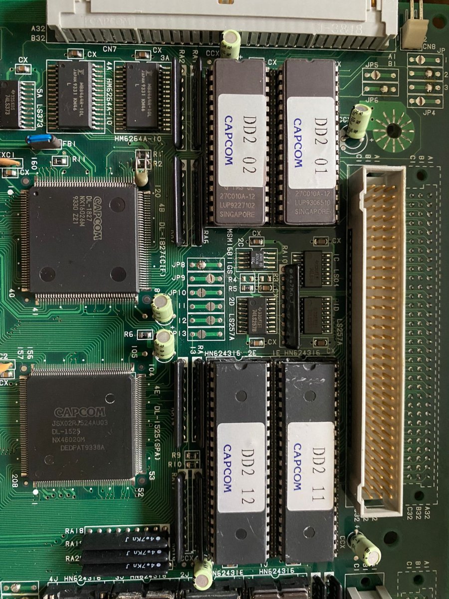

Does anyone have the jumper settings for a USA 93646b-4 darkstalkers? Did all the basic stuff to try and get the lines to go away

Does anyone have the jumper settings for a USA 93646-b darkstalkers? Did all the basic stuff to try and get the lines to go away

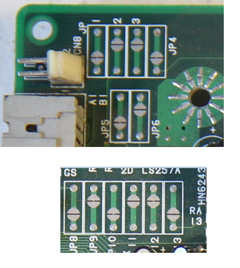

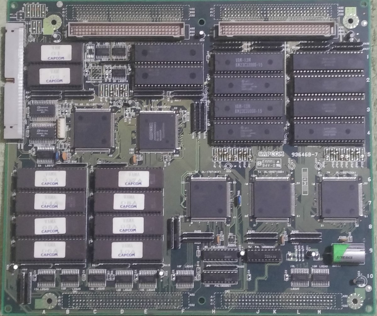

Its missing from the jumper list, I never noticed. Luckily MVSscans to the rescue.
This one is Vampire (JPN) but the jumpers are consistent across regions so same same for Darkstalkers
https://www.mvsscans.com/index.php/File:Cps2_darkstalkers_the_night_warriors_set1_mb_top.jpg
Agree with @Astro X normally if I had graphics glitches I'd be looking for a broken pin or a bad data line, but in the case of conversions I've also seen a misplaced jumper causing graphics glitches. Good explanation of why this happens in "the book of CP-System" by Fabien Sanglard
Vampire/Darkstalkers is an awesome game, excellent choice for conversion. Like XmenCOTA it is often overlooked. To see those OG darkstalkers (or OG Xmen) with every frame ever composed, gotta go to the source (later games in both series sacrificed a few frames for more characters)

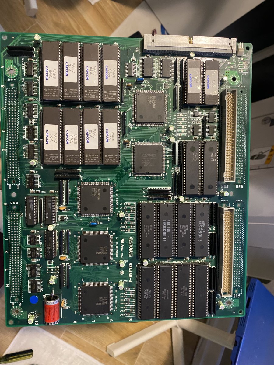

I just want to make sure it’s not the jumpers because it looks like someone has messed with them recently(fresh leftover flux , fresh blade mark cuts)
My board is a rev 4 board also, and the one you pictured is a 7 ; they’d have the same jumpers?
Yes, same jumpers regardless of board revision.
those jumper settings assume original ROMS or a 1:1 conversion. The jumpers are basically telling the board how many roms and of what size to expect in each socket.
So that might be worth checking too, If the conversion uses rom-doubled chips, or spilt roms or etc then might need the calculator
Got a picture of the board?
Still running battery too😅 maybe it’s crapping out , causing data loss??
