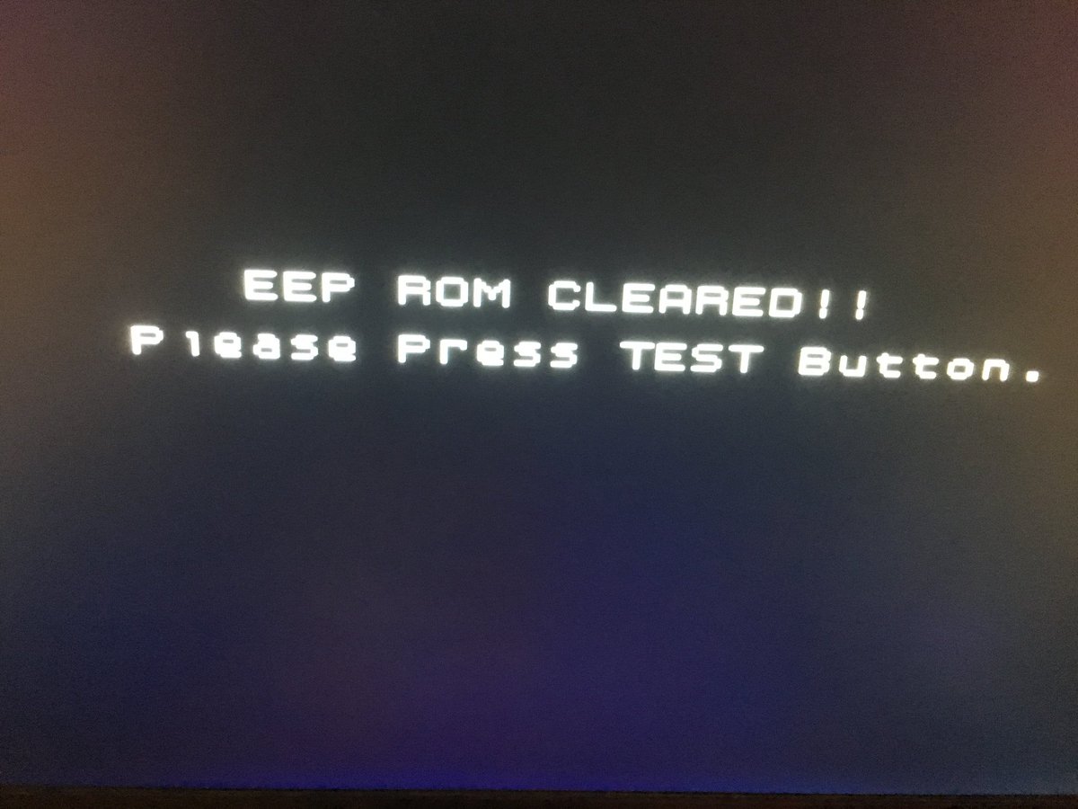

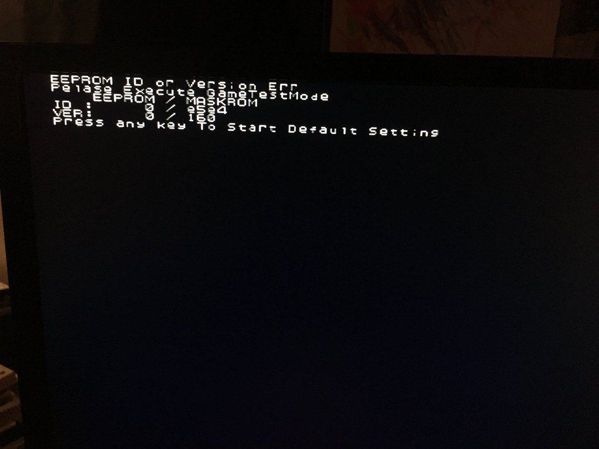

Now here is the kicker... I noticed the first time I loaded "ggx_v2p.bin" it comes up saying I have an "EEPROM ID or VersionErr" and instructing me to go into GameTestMode.

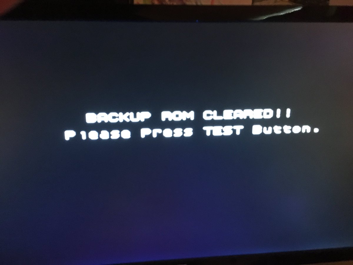

In doing so I was presented with some status info:
"BACKUP ROM CLEANED", and "EEP ROM CLEANED", and instructed to press my test button twice before the game would boot.
These strings are in the rom seemingly related to what it is doing when it cleans things up:
USER EEPROM GET FAILD !
USER BACKUP GET FAILD !
USER EEPROM GET SUCCESS!
USER BACKUP GET SUCCESS!
USER EEPROM GET FROM BANK 0
USER BACKUP GET FROM BANK 0
USER EEPROM GET FROM BANK 1
USER BACKUP GET FROM BANK 1
USER EEPROM CLEARED!
USER BACKUP CLEARED!
EEPROM ID or Version Err
Pelase Execute GameTestMode
EEPROM / MASKROM
ID :%6x / %x
VER:%6d / %d
Press any key To Start Default Setting
BACKUPRAM ID Err
BACKUP / MASKROM
Since seeing these messages, I've now been able to play AtomisWave games just fine. I hope that is useful to someone.
*shrug*. I've noticed that from time to time I need to come back and repeat these steps.
Maybe the other games hit some corrupt bytes in BACKUP / EEP ROMS and that prevents them from booting?

Now the real question is why it has magical voodoo powers to fix my Black Screen on demand
probably because AW games was not happy with SRAM contents.
normally, NAOMI BIOS clear SRAM and EEPROM user area if game was changed (BIOS compare game ID in ROM header with stored in EEPROM last game ID). but all AW->N conversions have same ID (ABC0), so auto-clear not happen.
