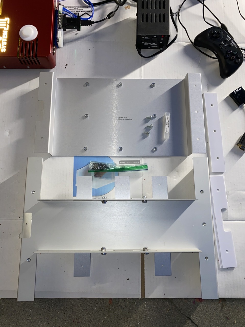

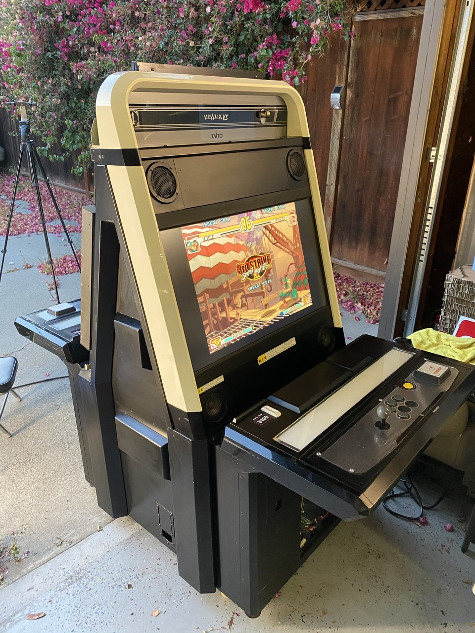

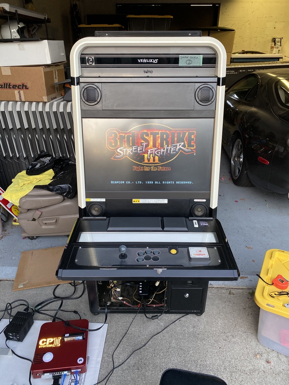

Sorry for the rushed pictures. But I also received the bracket and I’m currently test fitting it in my newly acquired Vewlix VS I got recently from David @GameSaru @Cereth.
I haven’t even had a chance to unpack the VS but as soon as I received the bracket I’m kicking it into high gear!
First impressions of the bracket... it’s very high quality produced aluminum frame. The bends and cuts look perfect and seems to have enough adjustability for some fine tuning.
I’ll be working on this throughout the weekend but I need to clean out the VS cabinet first. Here’s some pictures in the meantime.

**Note, picture below are of the Stock LCD, before the upgrade. Pictures will follow in the upcoming days.**

Lets talk about screw size differences.
On the left here is the original, on the right the replacement supplied with the bracket.
I'm using the counter sync kind because I'm also using the recommended counter sync bit.
On that note... Drill/sync holes...
A little backside sanding to remove nasty/sharp metal burrs.
Ok thats it/basically all the "prep" work you need to do on the IPS Alpha Tech (Diamond White) LCD/frame.
AKA guts removed, 6 holes drilled out/enlarged with backside sanding recommended.

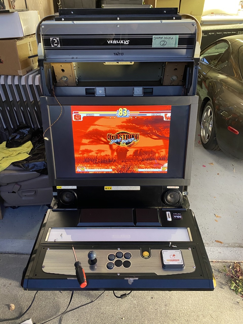

Alright here we are!

For now everything is fine, the monitor looks amazing of course.
I would like to do more glory shots, but the glare in the day from the screen is a real shot spoiler/a mirror.

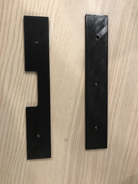

Previously I got a quote for the the spacer sheet but the price was stupidly expensive and they only had in inches instead of mm so I wasn't so happy with the availability and price already. So I turned to 3d printing. It's now a single 5mm spacer sheet instead of five 1mm sheets. For the first batch only, I'm moving forward with this solution.
