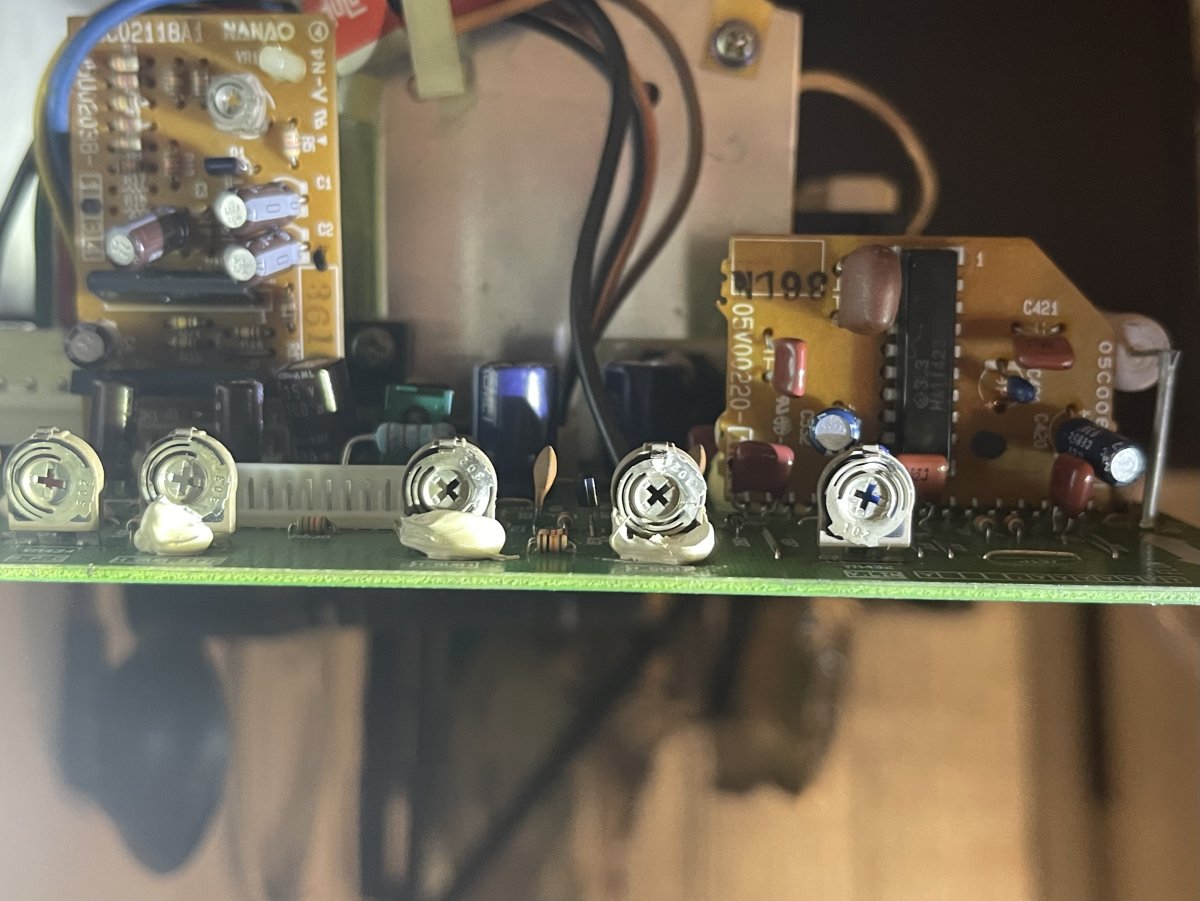

Okay, I've checked my cables and it's fine. I've boiled it down to the pots on the chassis itself. I might have to reflow solder to the joints on those. In the case that they are bad, are they 15k ohm pots? If I need to replace them, I want to make sure I'm getting the right ones.

The one on the chassis itself. Not on the controller.

also the vertical position is off and eventually goes to the right place. After adjusting the horizontal pots on the chassis, I haven't seen the horizontal stretch issue happen again. I adjusted the vertical pot as well so that even when it's messed up now, it's not quite as noticeable. It's just slightly high. I might just get replacement pots and replace them.
You can just replace a pot by the code number stamped somewhere into the pot Itself, for example 203 =20k ohm
I decided to try and see if I can replace these pots. Just to confirm, these are the values on the pots. It’s 5k, 30k, 3k, 3k, and 1k right? According to those numbers.

It seems like those exact values are kind of hard to find. It's usually 1K, 5K, 10K, 20K, 50K. I'm assuming 5K will work for the 3K and 50K will work for the 30K?
