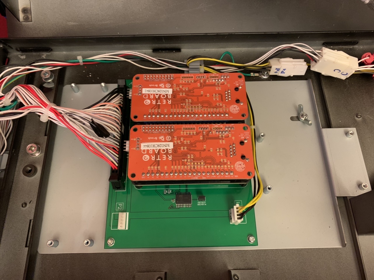

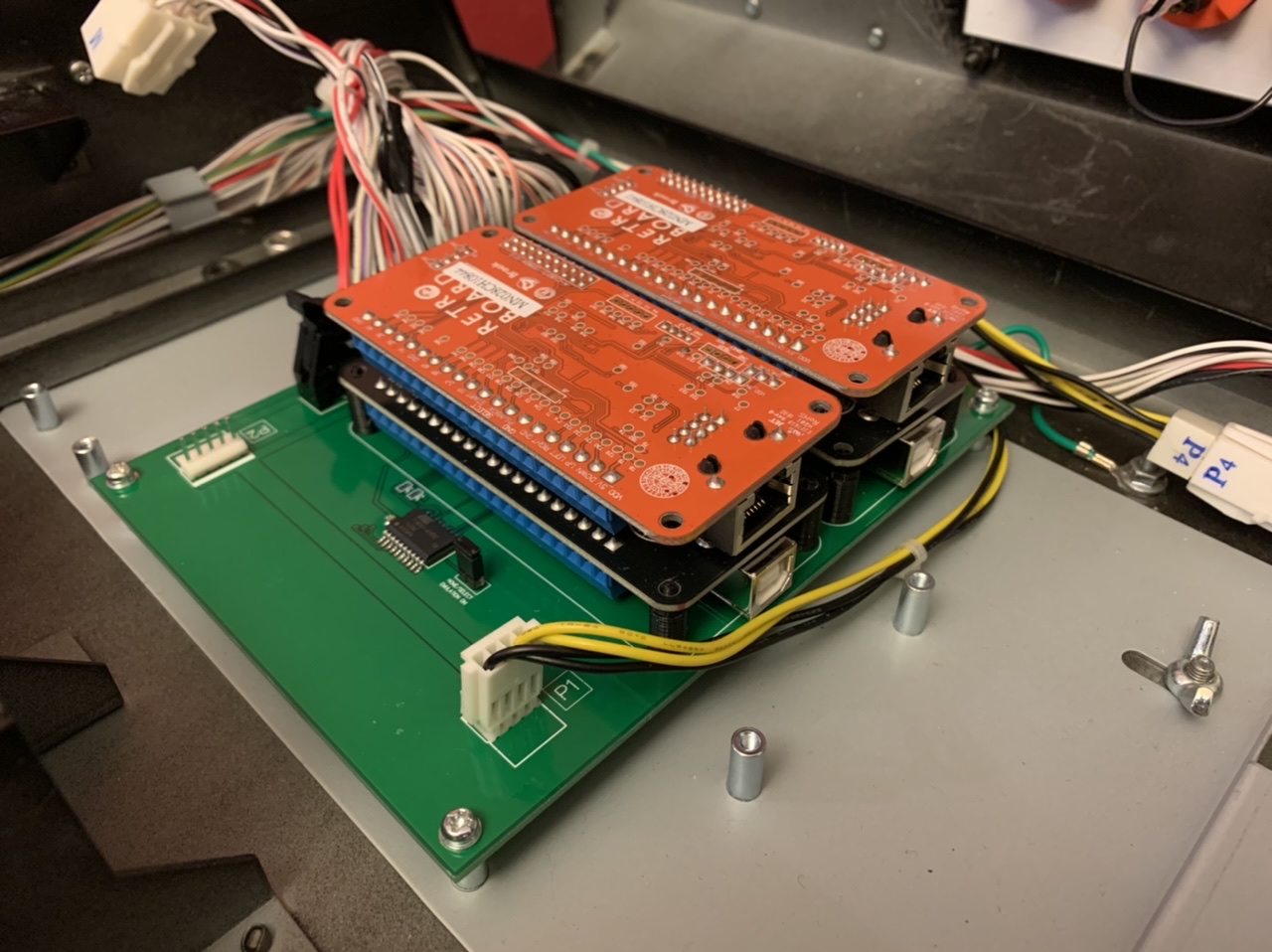

Just received the Vewlix Console I/O and couldn’t help doing a test fit. I’m planning on stacking the Brook Fighting 4in1 and Retro Board together.

Mine arrived today. I have your sega io adapter in the vewlix right now for some ringedge action so I won’t be installing it for a bit, but I’m glad to have it!
how will you make them link together?

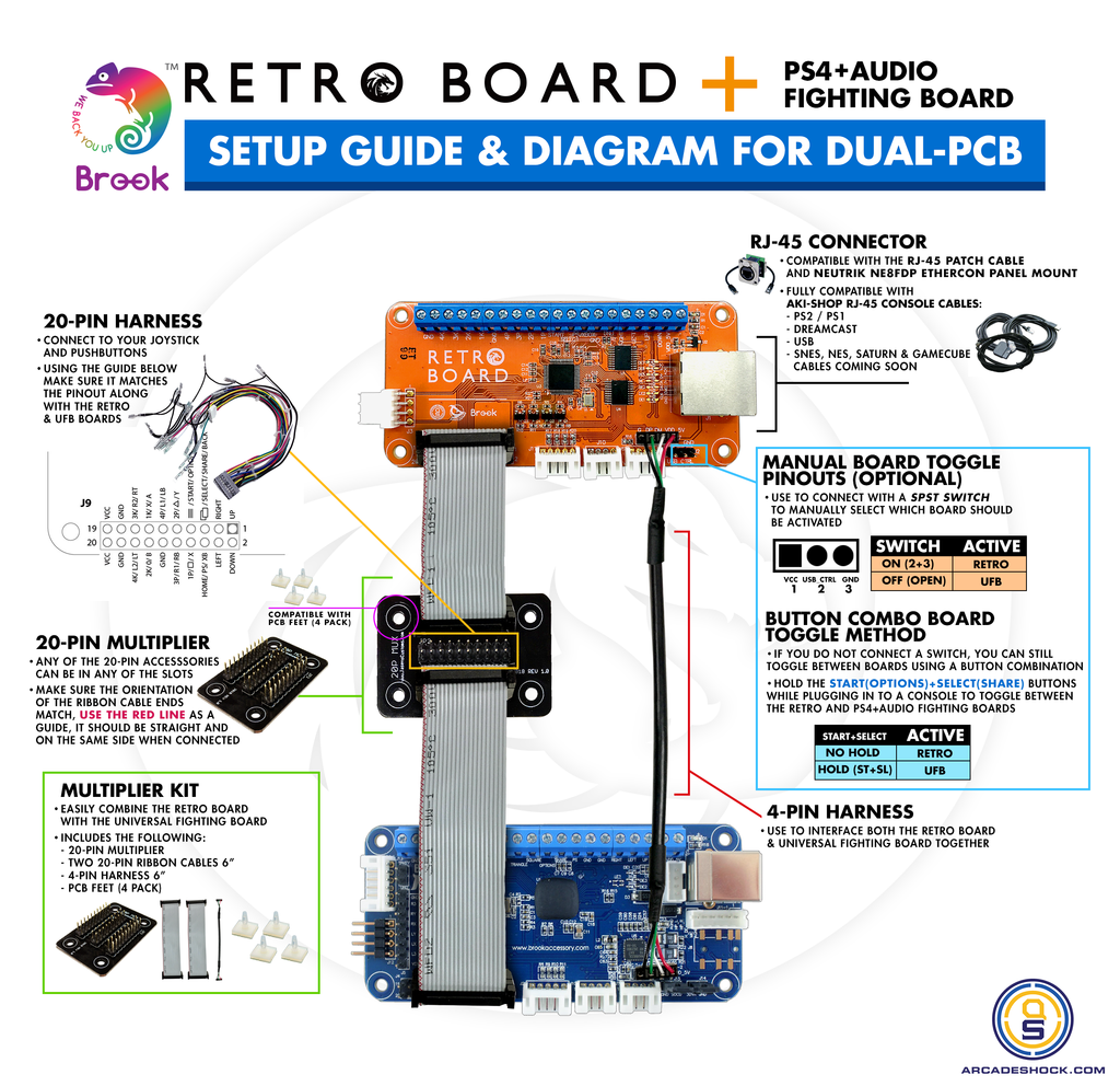

They are made to stack. You can switch between them via toggle switch or button combo.

Hi @Arthrimus, how do I go about wiring up for a button for select/home? How does the home/select emulation work?
Home/select emulation works using the following button combinations:
Select = B1 + B2 + Start
Home = B2 + B3 + Start
If you wish to wire up physical home and select buttons directly to the board you need a JST XH 6 pin cable crimped with quick disconnects on one end. Simply follow the pinout printed on the PCB below the connector.
