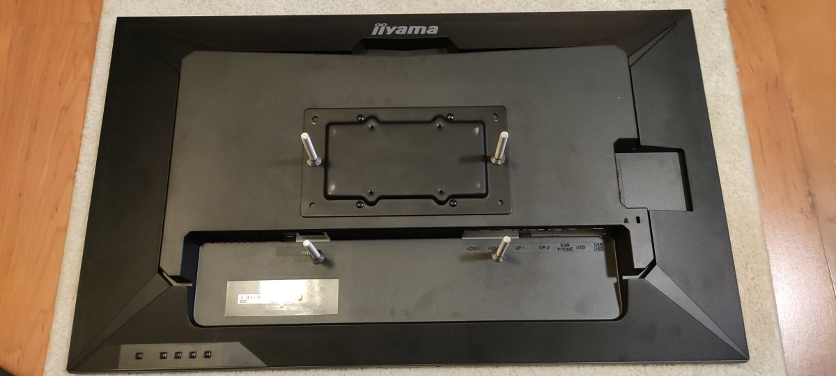

The VESA 100x100 hump format is key on this project,it provides an empty space to drill two kind of VESA screws.
This image is just for reference about how the Allen screws position:

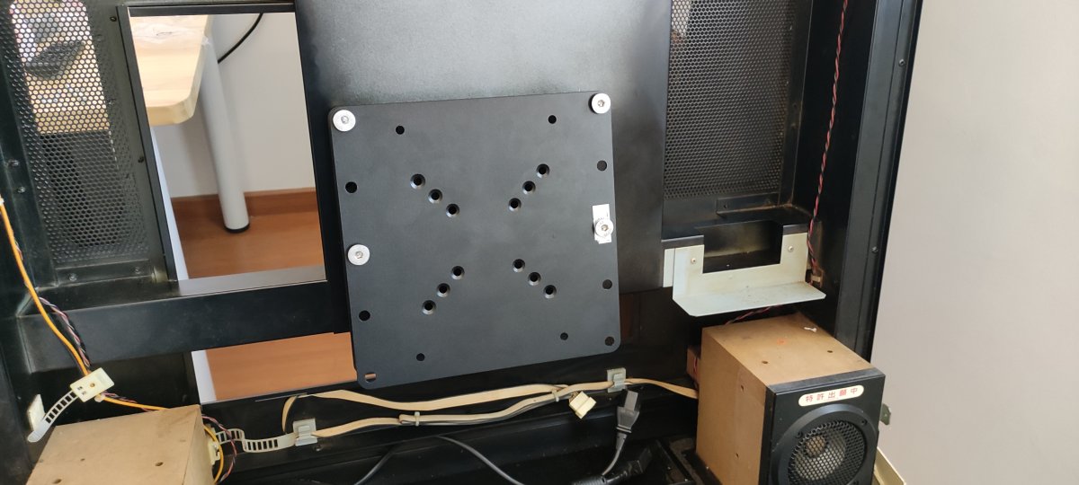

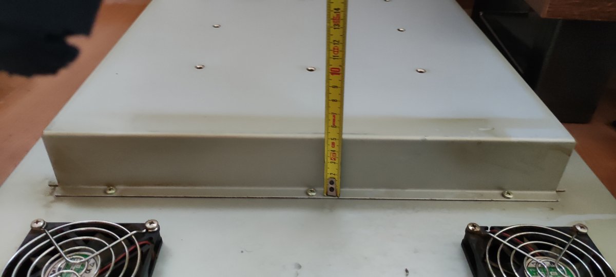

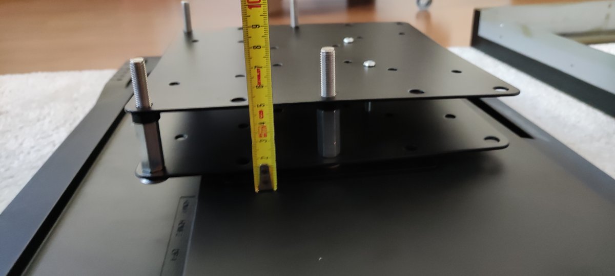

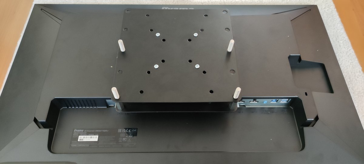

I did two additional holes (the original has not) in the two big VESA plates to fit the measures (200x200&100x100) in the existant cabinet holes and created a 2x VESA mount squeezing the screws and hexagonal nuts firmly,as you see the mount has the same measures as the hump in the stock monitor:
It is set in the cabinet using the two existent holes (just for position reference):

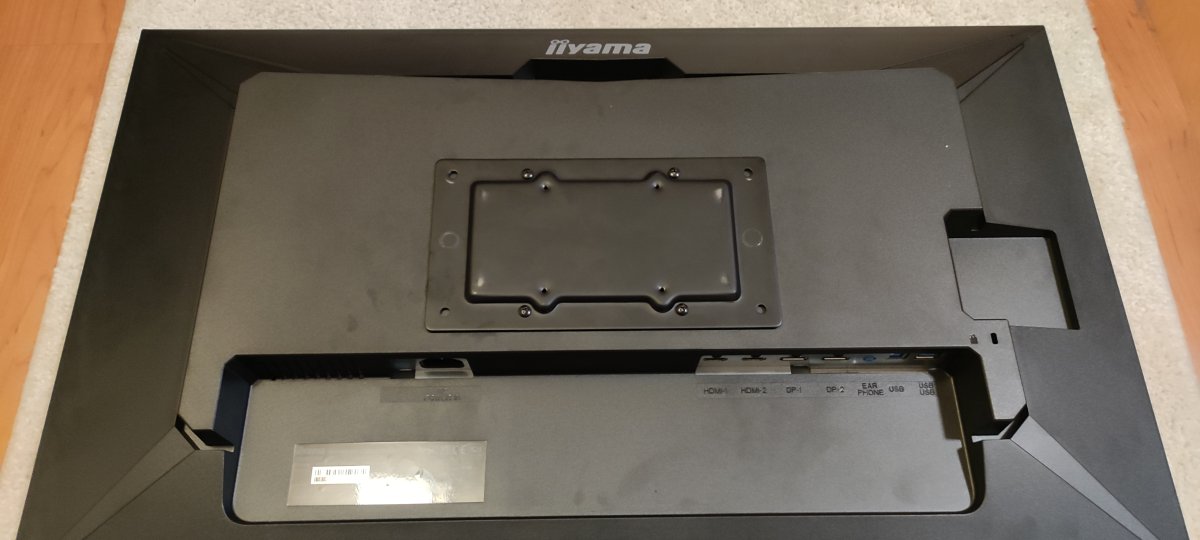

I set it in the monitor with the 4x VESA additional screws in the 75x75 holes: (Take care setting up the small screws to avoid damage in the plastic monitor!)

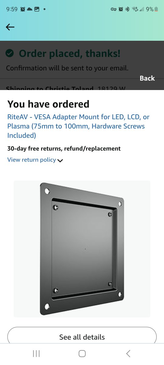

Hi, I am not sure what the 75x75 to 100 adaptor is used for yet. I am not quite understanding that part but figured when i open up the vewlix, it will make sense. However, the one you purchased seems to be rectangular. The closest I could find is this square one. Would it still work?
