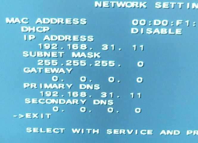

The link to the old picture of the network setting for Virtua Fighter 5 FS isn't working anymore. Lucky I saved it before Photo bucket high jacked it. Here it is again for anyone else in the future who needs it.
Thanks! I believe I will need it pretty soon. :)

I am running into this same issue now. I am using a noami 2 jvs to jamma and how do I enter the network settings? I assume I need a type 3 sega jvs?
