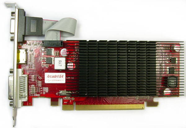

I would like to connect an ArcadeVGA video card to the arcade monitor using the arcadeVGA VGA connector..
https://www.ultimarc.com/avgainf.html
Not sure if you are familiar with Multisync arcade monitor but a Multisysnc arcade monitors power cable connects directly to the wall like a TV and they have a VGA input where a computer can be connected to the ArcadeVGA. So we are trying to recreate the functionality of the multisysnc monitors.
"The Ultimate PCIe Video card for gaming on 15Khz Arcade Monitors and PC Monitors
Vista/Windows 7 and Windows 8 32 and 64 bit drivers included. Also XP 32 and 64 bit.
RUN CLASSIC GAMES IN THEIR NATIVE RESOLUTIONS!"

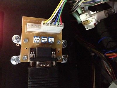

From the eBay auction, I am very sure that the adapter on the picture will work but the eBay adapter does not have the CGA cable that it is showing with yellow, white, black, blue, green, red that goes to the monitor and to the ebay adapter; I do not have that cable. in summary.. if you can provide the CGA cable, then I can buy the eBay adapter.. or if you have another solution that would work that will be great as well. The eBay CGA to VGA adapter has a built in bust signal that is require for the PC to show a good picture on the arcade monitor.

Ok. I see now. Give me a few days. This is still going to connect to a k7000 right?
I would like it to connect to any standard 15khz arcade monitor.. is that possible? What I am thinking is the future.. I do not want to hunt down a multisync monitor and pay a high price once my monitors died or something.. I want to be able to use the power adapter that you created and the VGA cable/adapter with any 15khz arcade monitor.. is that possible or am I completely off my rockets?:)
Well the RGB/Video connector varies between manufacturers and sometimes generations so you would need power adapters and video adapters whenever you switch monitors. You mentioned you had several WG monitors. They should all have the same video connector as you showed in the early picture. I can make that one now. If you switch to a Polo, etc. you will need adapters for them to work. I would just cross that bridge as you need to. The early monitors were pretty standard as far as the video connector. Fr example the Electrohome G07 (awesome monitor if you can find one and rebuild it) uses the same video standard but you would need to split the connector as it's two connectors rather than one straight connector. RGB is on one connector and video ground and sync are on the other. If you buy an old game that haas an Electrohome and the video connector looks like it was snalled in half and plugged in then you can be sure someone replaced a WG monitor with the Electrohome.
i see.. I understand and since I do not know which monitor I will be using in the future just bill me for what you have done and the shipping. we can revisit this in the future when one of my WD 9200 or 9800 dies. I was actually planning on using the k7 monitor as verticall but then I found the 9200 which is what I am using:)
