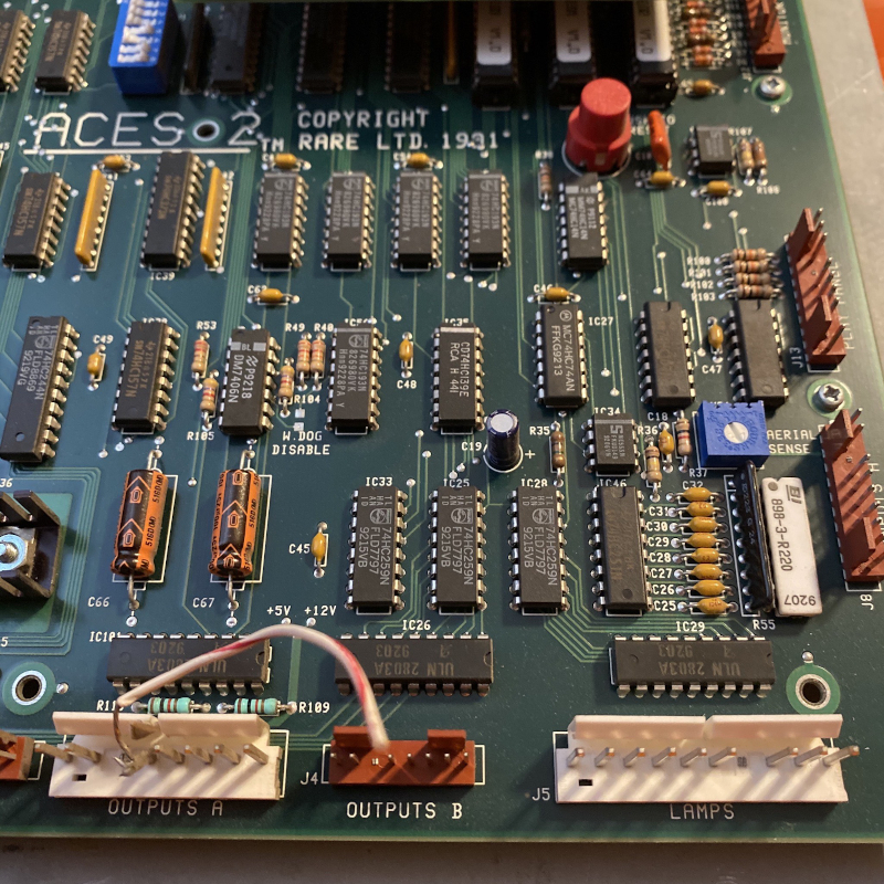

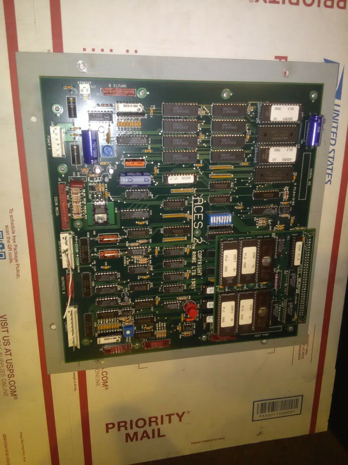

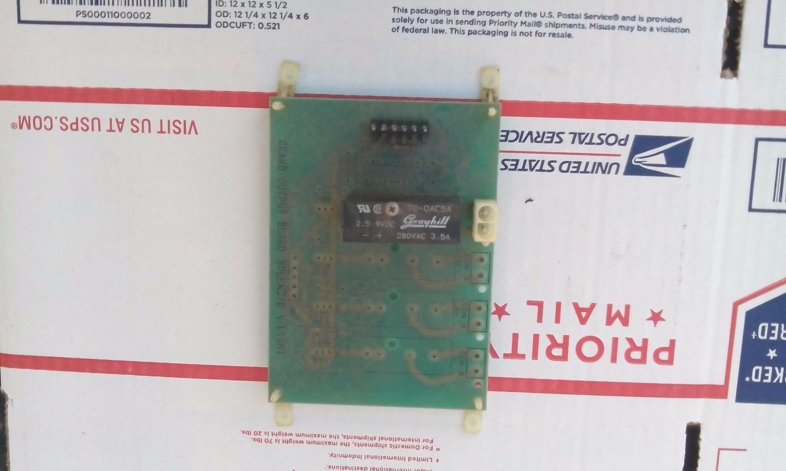

I just purchased an X the Ball PCB. The listing says "non-JAMMA" so is there a way to get it to work with the HAS? I've attached the picture of the board I bought (listed as working by the seller). There is also another small PCB the seller has listed for the same game but I have no idea what this is for (I attached this as well); does anyone know if I need it to get the game working or if the one large main PCB I already bought will be enough?

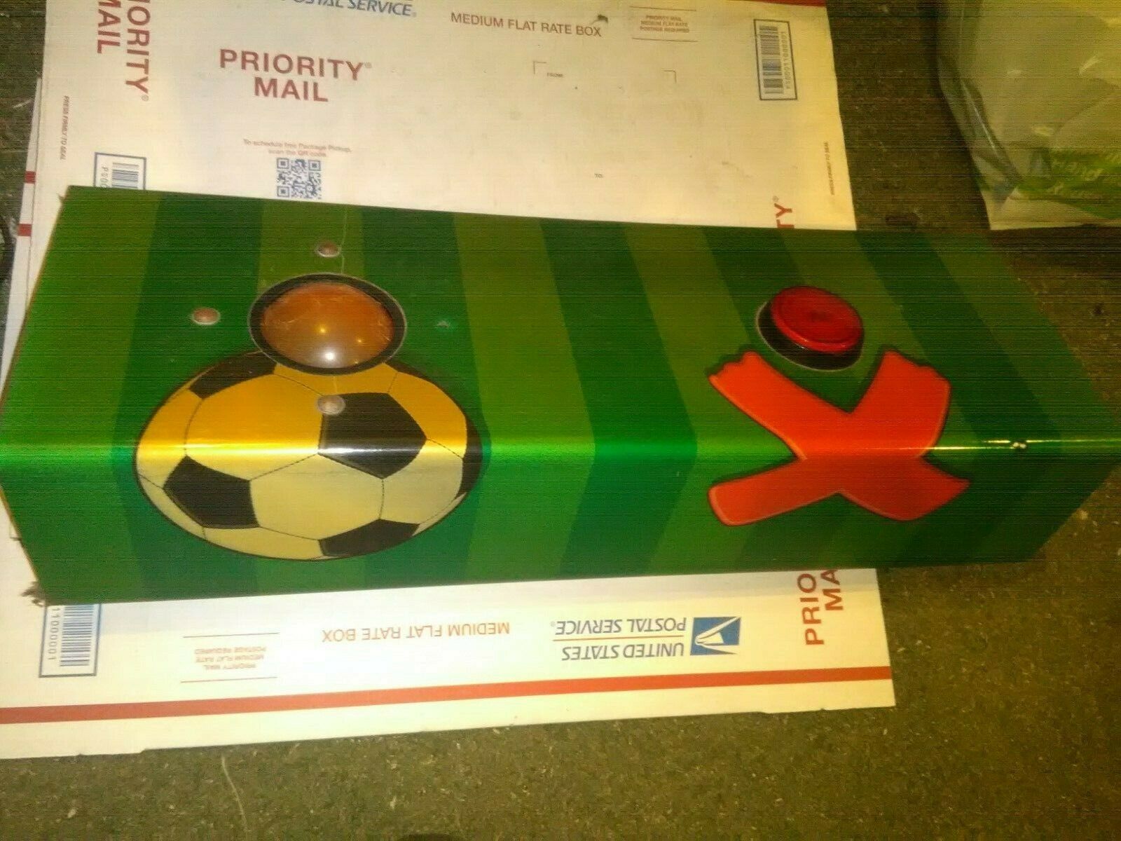

This game is controlled by a trackball and button. Are there cheaper generic trackball+button combos available for purchase somewhere, or do I need to buy the official X the Ball one the seller has listed? (also attached)
And I don't even own a HAS yet. I just bought this board because I don't think it's all that common so I just wanted to secure it for myself since it's one of the five arcade games I want.
Since it looks like this game dispenses tickets, even if I don't have the ticket dispenser hooked up (I think the seller actually has some ticket-related stuff for it listed) will I still be able to play the game? Or will the game give some kind of error message if it doesn't sense a dispenser or if it isn't able to dispense?

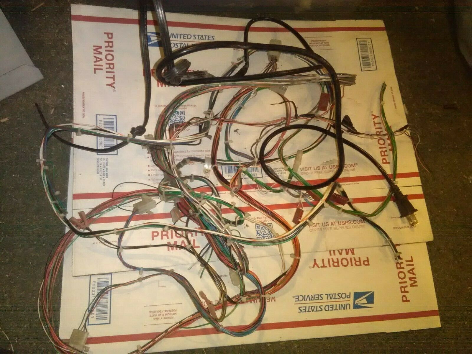

Also the seller has a bunch of cables for it listed but I doubt I will need them (attached). Is anyone able to confirm?

So it sounds like if I have the main board, providing it doesn't need the lamp or dispenser attached, then I should be able to get it working with just an adapter... Any idea at all if I'll need to actually buy the trackball/button combo from the original arcade machine or if there is a generic trackball/button combo that may work?
Yes, that's KLOV.
You may want to try Arcade Classics FB group? Fair amount of old ops on there.
The button definitely doesn't need to original, and it's *unlikely* that the trackball needs to be original.
Figuring out the pinout for the power connector and monitor should be your first step. If you could get it powered and displaying you'd be well on your way.
But at least as far as I can see from the couple of PCB photos online, they connectors don't seem to be labeled (like it says MONITOR, but it doesn't show which pin is which for RGBS). Does the reverse side of the PCB have any silkscreen?

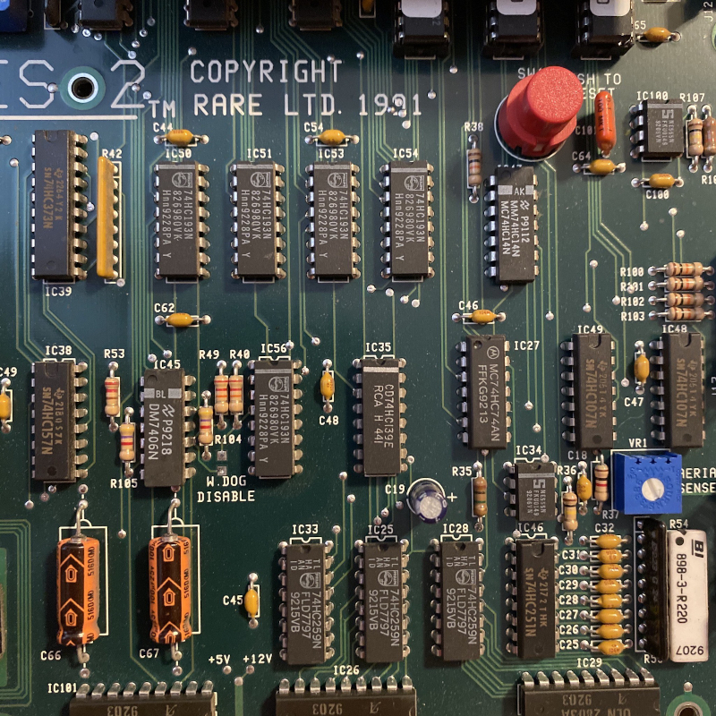

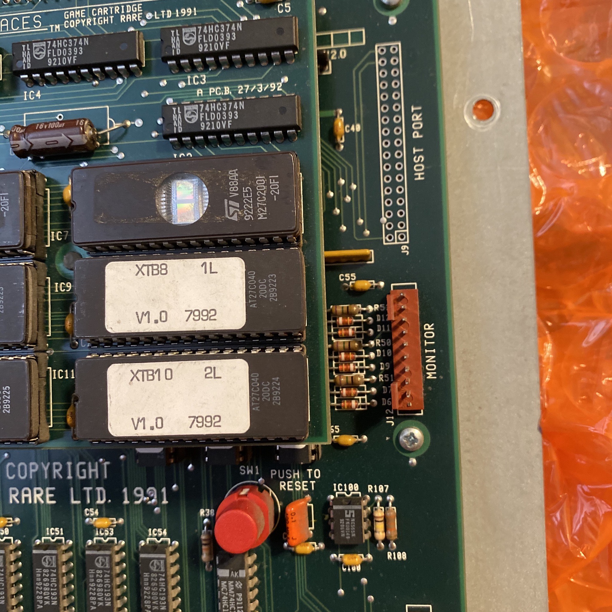

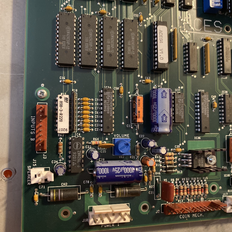

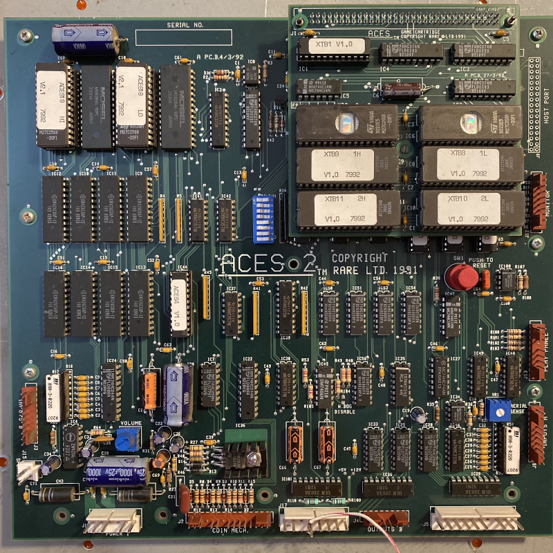

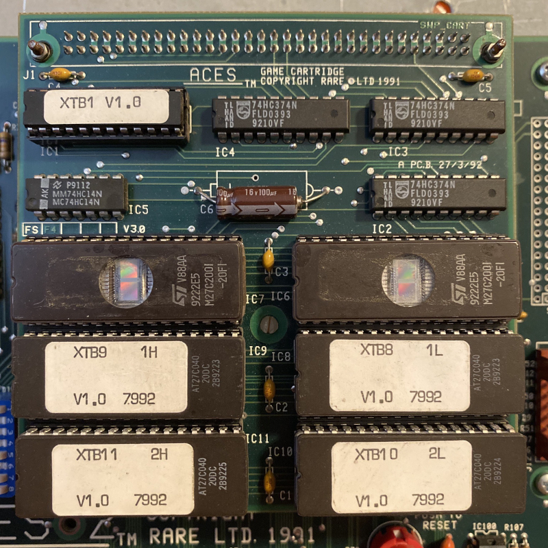

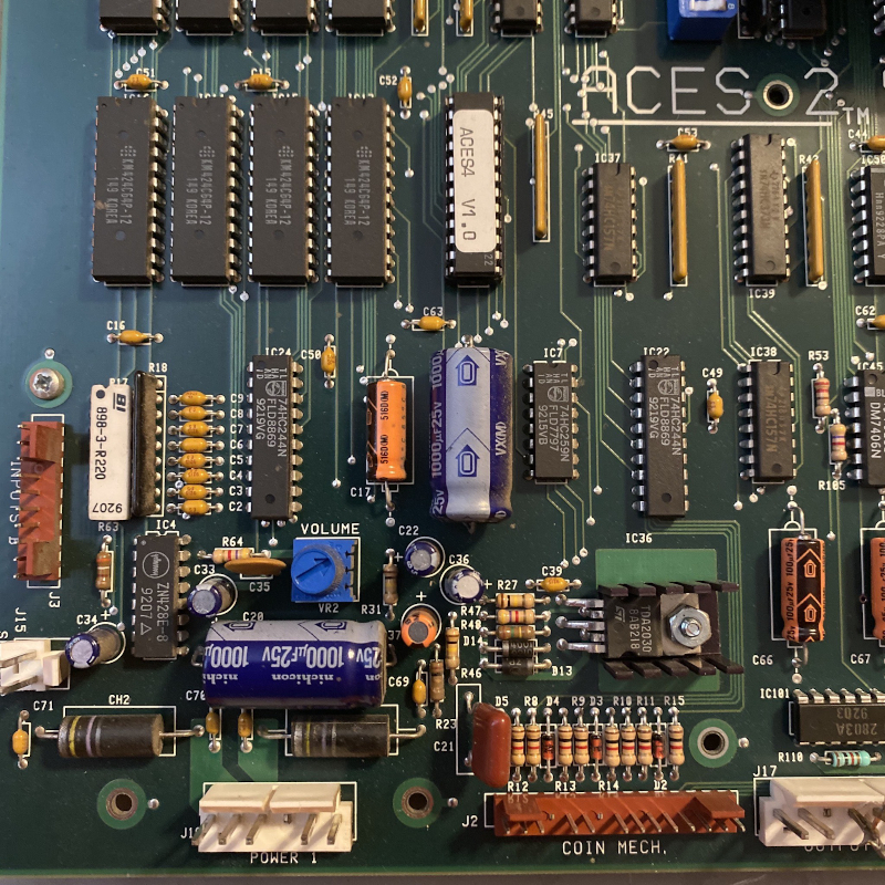

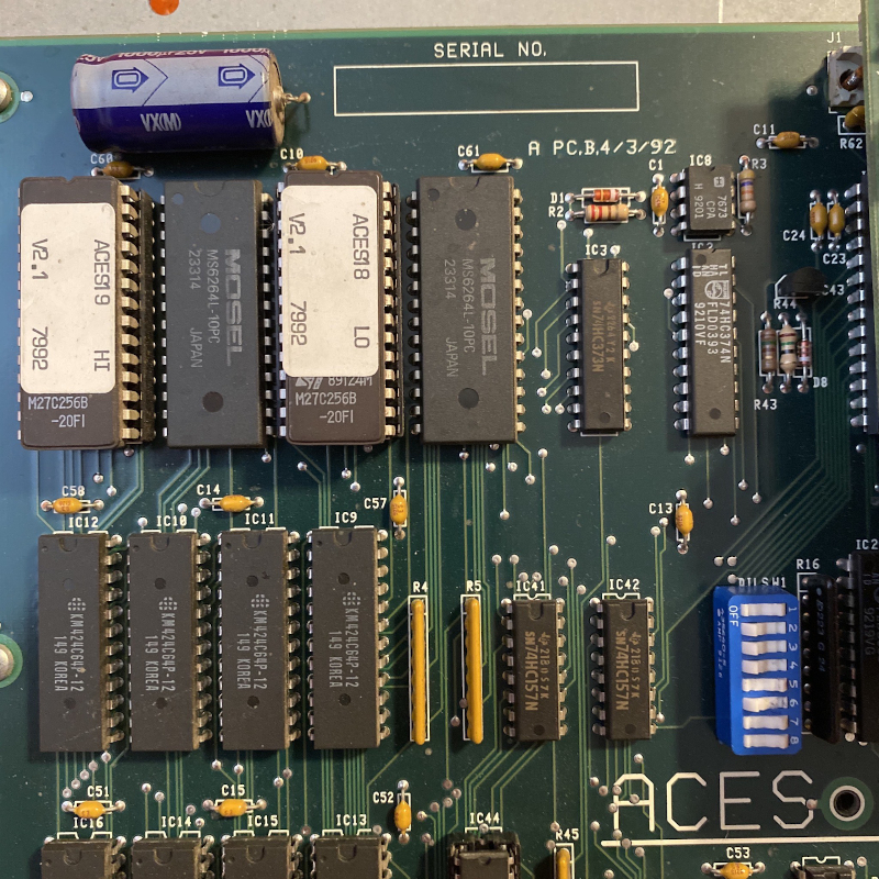

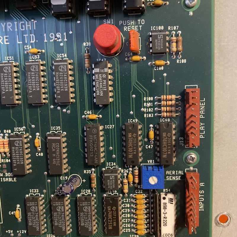

So I received the board today and took pictures. Not sure if this does anything to help, but if anyone is able to get any ideas from these pictures please let me know!

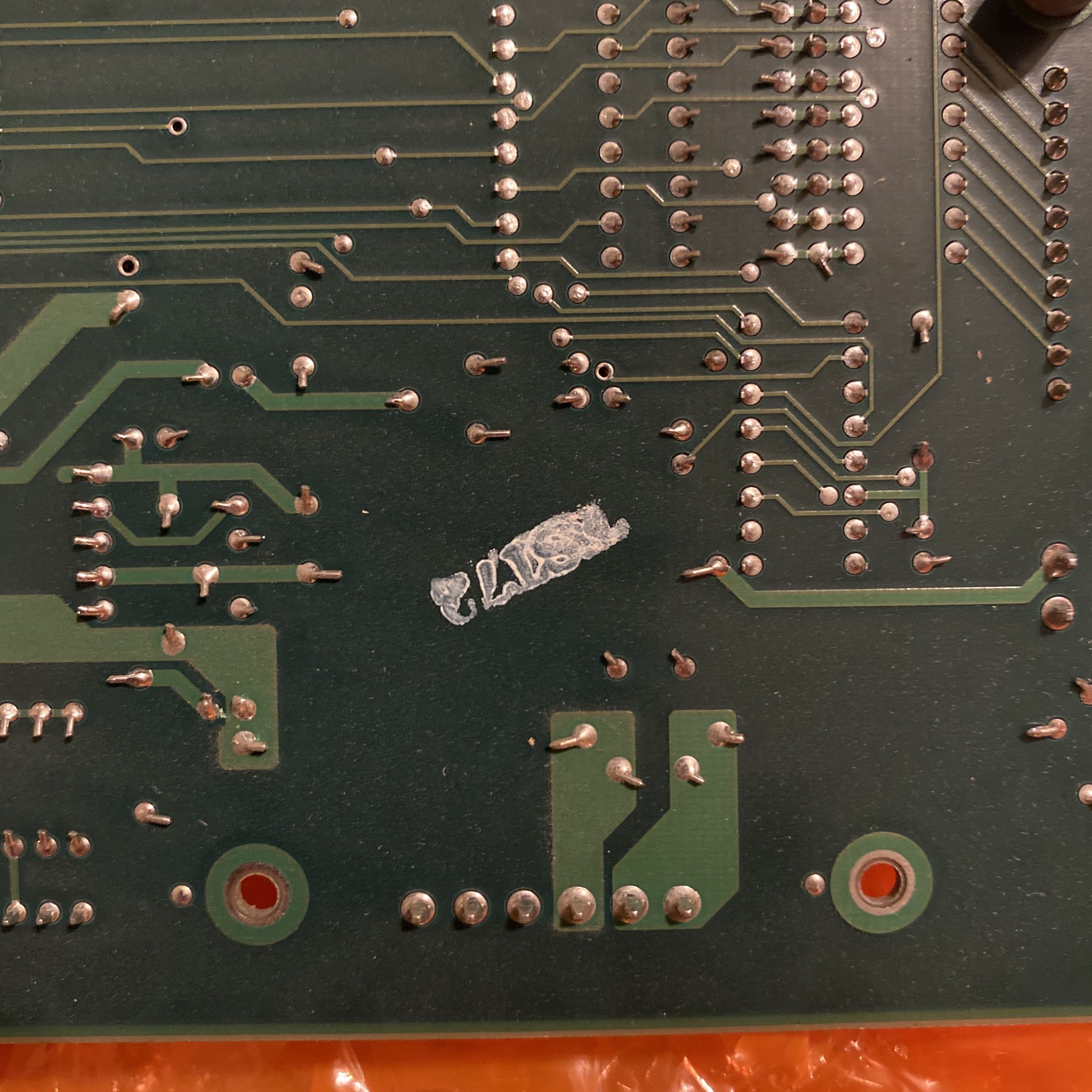

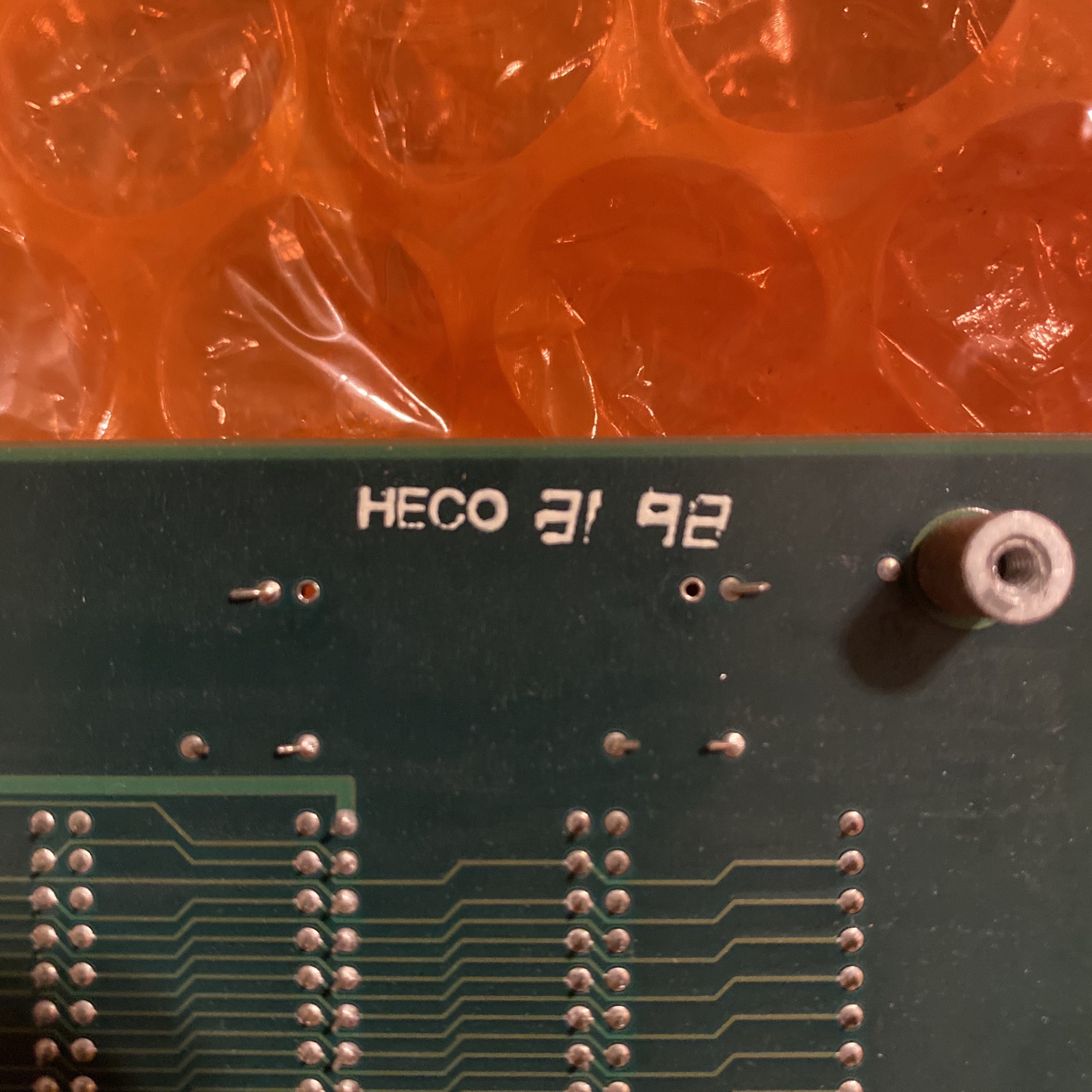

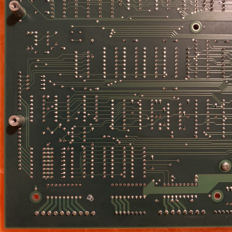

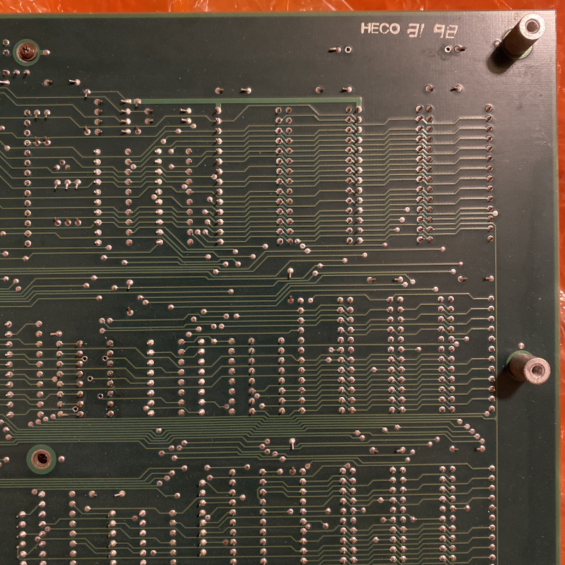

Can you see if there is any writing on the opposite side?
SMALL chance the pinout is printed on the underside of the connectors?

Interestingly this game is in MAME: https://github.com/mamedev/mame/blob/master/src/mame/drivers/xtheball.cpp
unfortunately there is little to no documentation about the pinout in mame, but it's an interesting title. Redemption collab between Capcom and Rare.
worst case you can work backwards to figure out the pinout if you've got a multimeter and a scope and some patience.
thankfully it looks like the primary function of most of the connectors is spelled out already.
start with writing down a list of connectors and a numbered list of each of the pins on each connector (there is usually a mark or some indication which pin is pin 1)
then pick a common chip on the PCB such as anything with a 74xxxxx. google the pinout and determine the 5V and Ground pins, then go through all the connectors and determine which pins have continuity. to 5V and ground and mark those on your list.
then you can start narrowing things down, look at the power connector and determine which pins ARENT power or ground and follow the traces to a chip, then look up the pinout for that chip to see what kind of power input that pin typically accepts.
for the video connector you should expect a ground pin, a sync pin (Which will have a 15kHz pulse) and 3 color pins which will have floating voltages you can use a scope to determine the pulse pin and the color pins.
try to identify an audio amplifier chip, look up the pinout for that and follow the output traces to determine the audio output pins. you can also poke around with a scope to help with this.
then that leaves the input pins we know a trackball typically has a 5V, a Ground and then 2 plus pins. once you've identified the 5V and groun pins on the input connector and you've got the audio and video working to a point where the game starts up and you can hear and see it, then you can take a wire and connect ground to each of the unknown input pins to see if you can figure out what they do.
EDIT: you might want to also put stickers over the exposed windows on those chips less UV light will erase or corrupt the data.

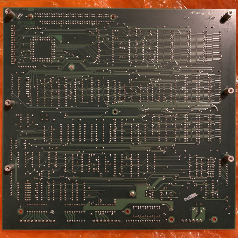

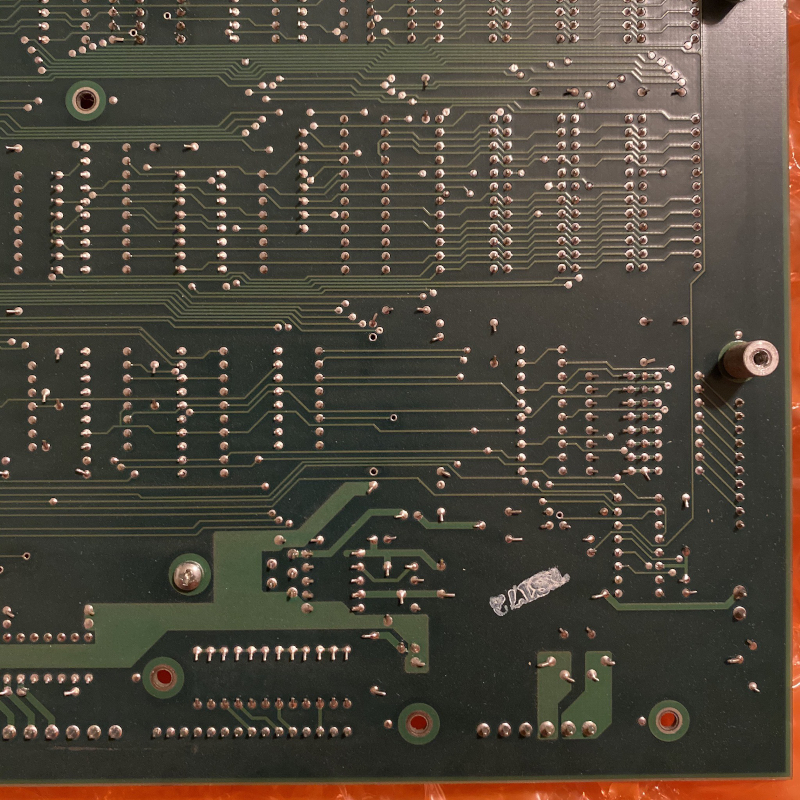

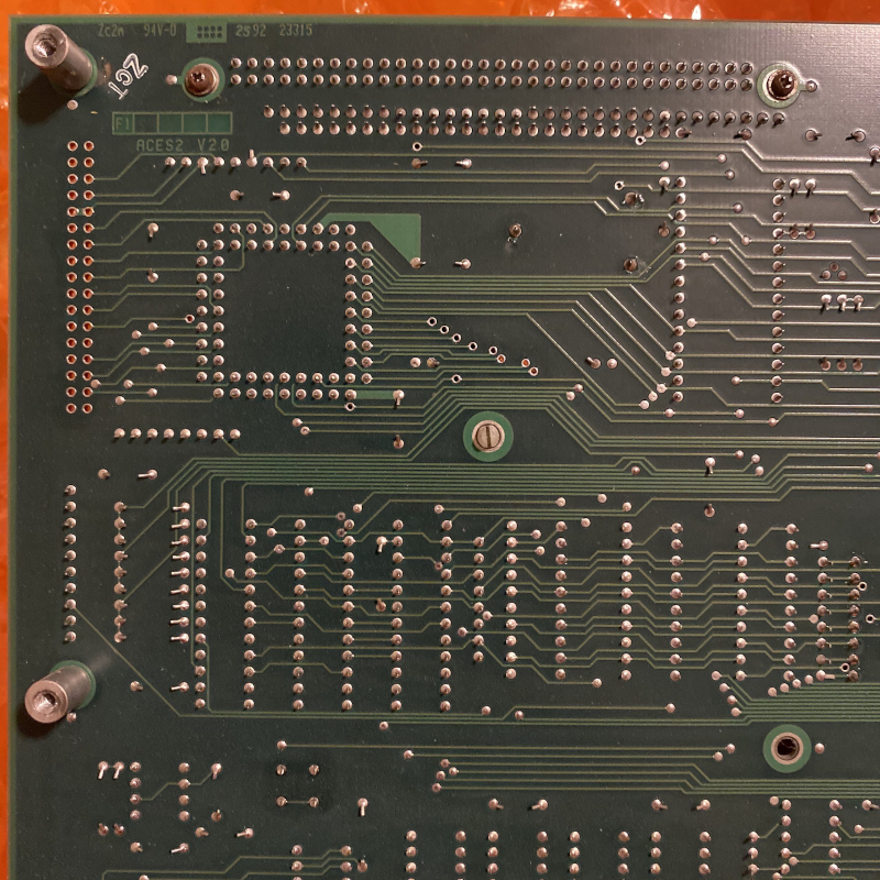

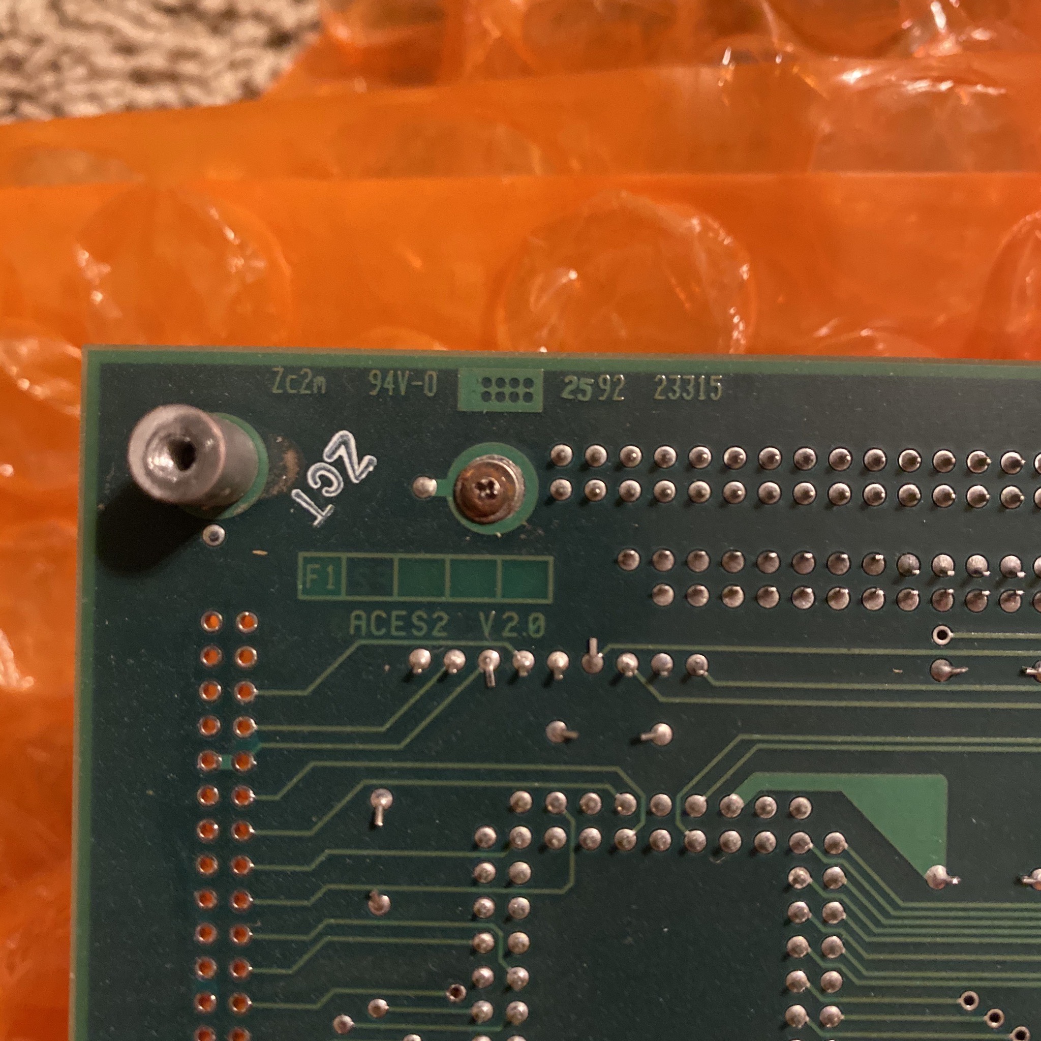

Okay the PCB is screwed onto a sheet of metal so I'll have to unscrew it and see what's on the other side. And yea that person is going to scan the manual for me. I offered to pay them for their time if they could scan the whole manual in good quality so that I can upload it to archive.org and/or an arcade website for preservation.
Okay so I took a picture of the whole backside, one picture each of the four back quadrants, and then three separate pictures showing any text that was visible. I'm guessing this won't be useful at all? :/

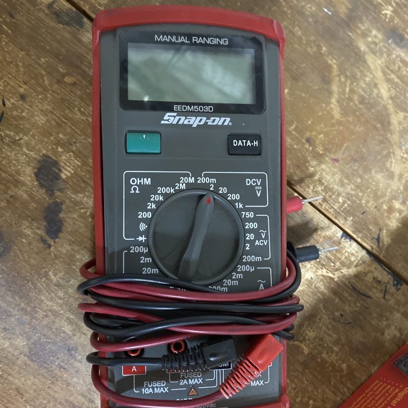

Okay, I already have a multimeter, so how necessary will an oscilloscope be? And about how many hours do you think this will take, so I can plan a day out of it?
you can do it without a scope, but determining the sync pin on the video out will be more difficult. if your multi meter has a frequency function then a scope is completely unnecessary.
I've done this before on other PCBs and it's taken me way less than an hour (probably about 20-30 minutes?) but that's with pigtails for all the connectors and a finger board/ JAMMA setup to test on.
Here is what I'm working with

So does mine have the frequency function?
That's not a function I've ever used. I was just reading that brand name there, ha.
You can find the 5v/ground/etc as @twistedsymphony was saying by using the dot with 3 sound waves coming out of it setting on the left there. Should get you to a point you can power it up at least for now!
Take this datasheet and find the GND pin and put one probe on that, put the other one on the power connector.
https://www.datasheets360.com/pdf/-5967810087723673588
Do the same for vcc.
Now you've found which wires are 5v and ground for power.
Speakers should be self explanatory.
So you should be able to see if it boots and plays blind at least!
Assuming nothing is wrong with it, and assuming attract mode has sound...
