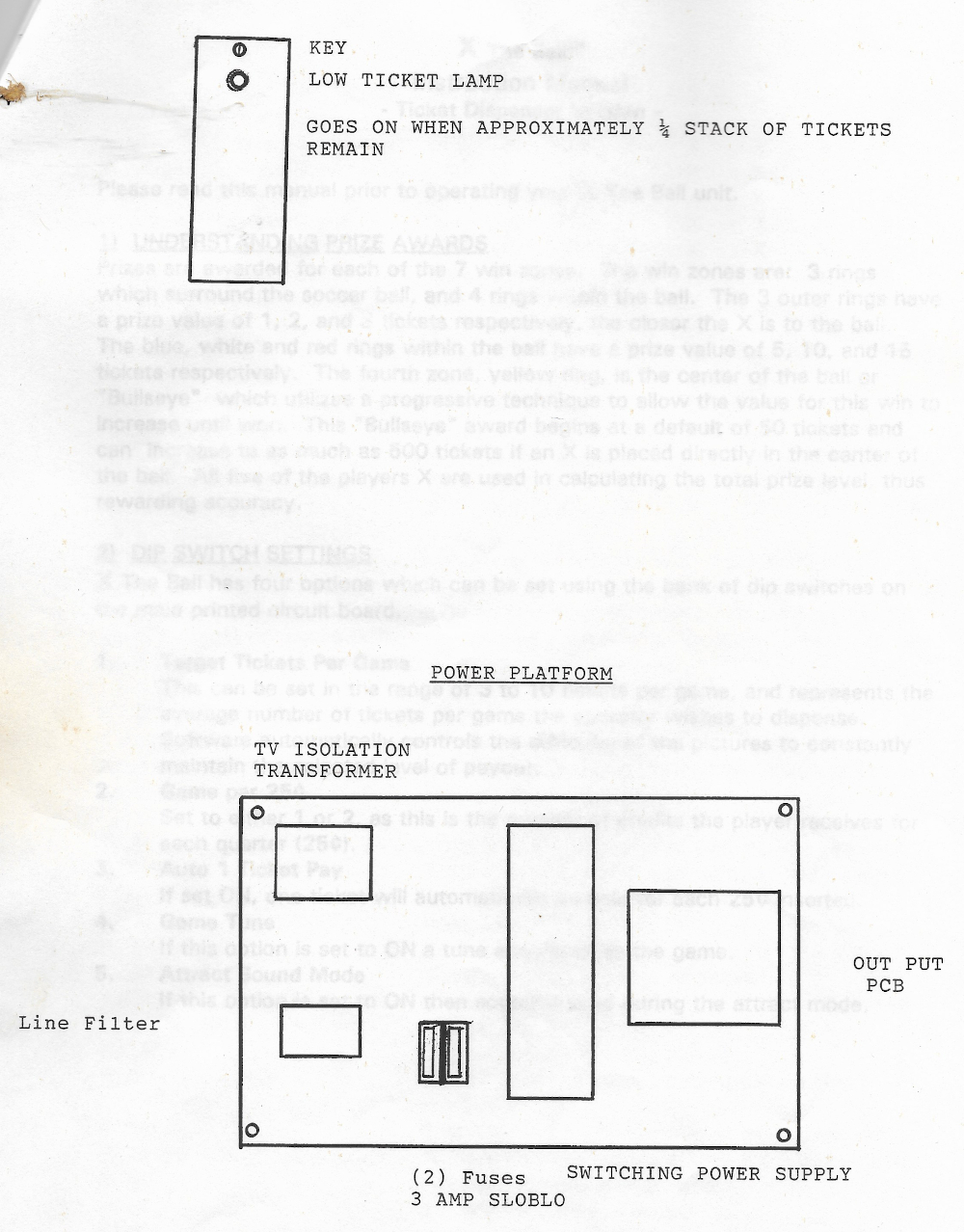

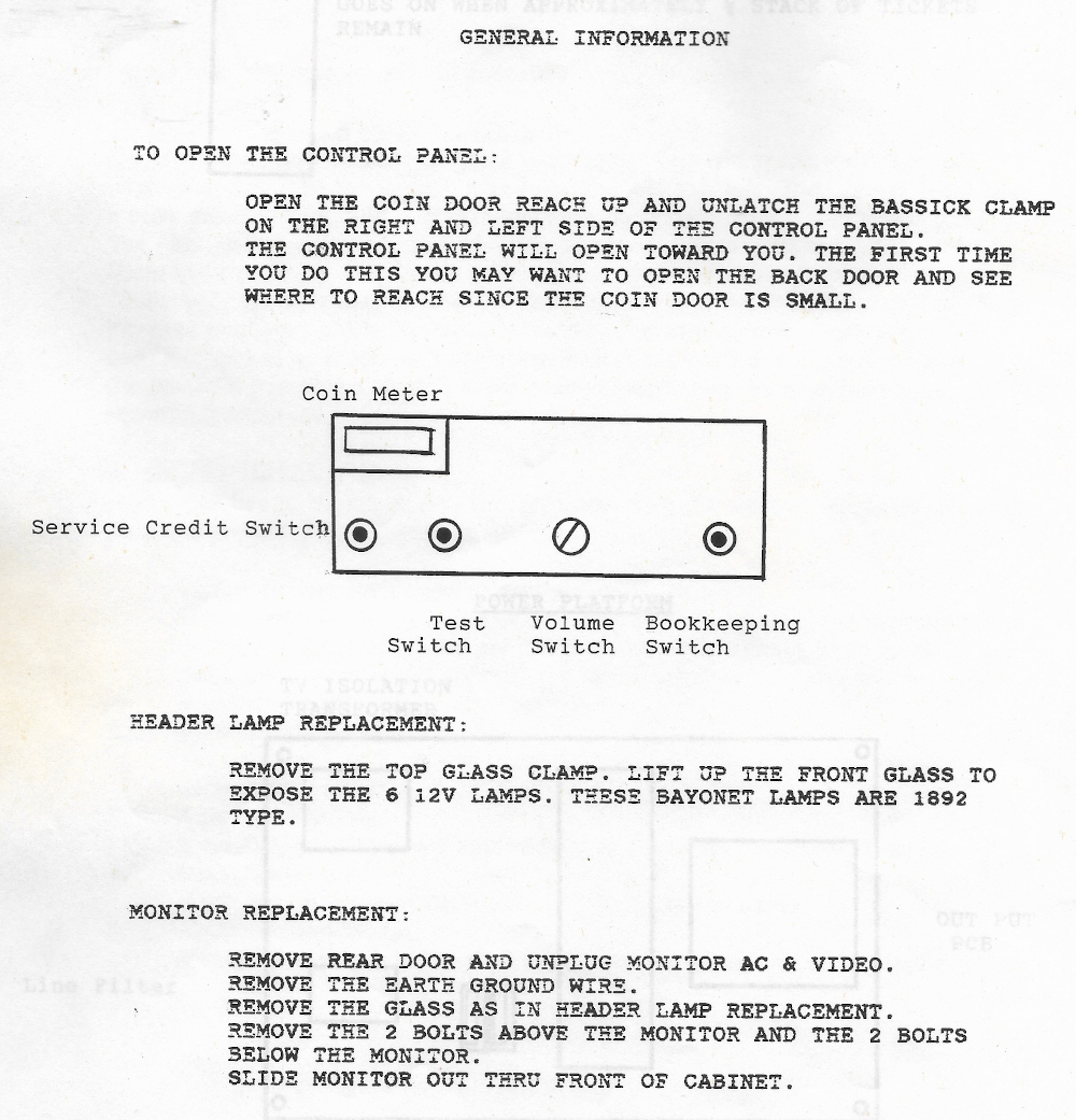

Okay here are some of the manual pages. It's good that the dip switch settings are listed, but none of this stuff will actually help me with figuring out how everything connects huh? So I guess I'll have to figure it out myself

Wow. That’s rough, the manual doesn’t address the mystery pcb or any of the pins on the main pcb.
