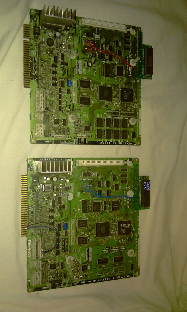

ZN1 Bios <V2> board arrives!
V1 and VFinal side by side...
Not much change overall by looking.... however much easier to install ;)
I have around 6x bios final boards available from this run, contact me quickly if you want one :P
