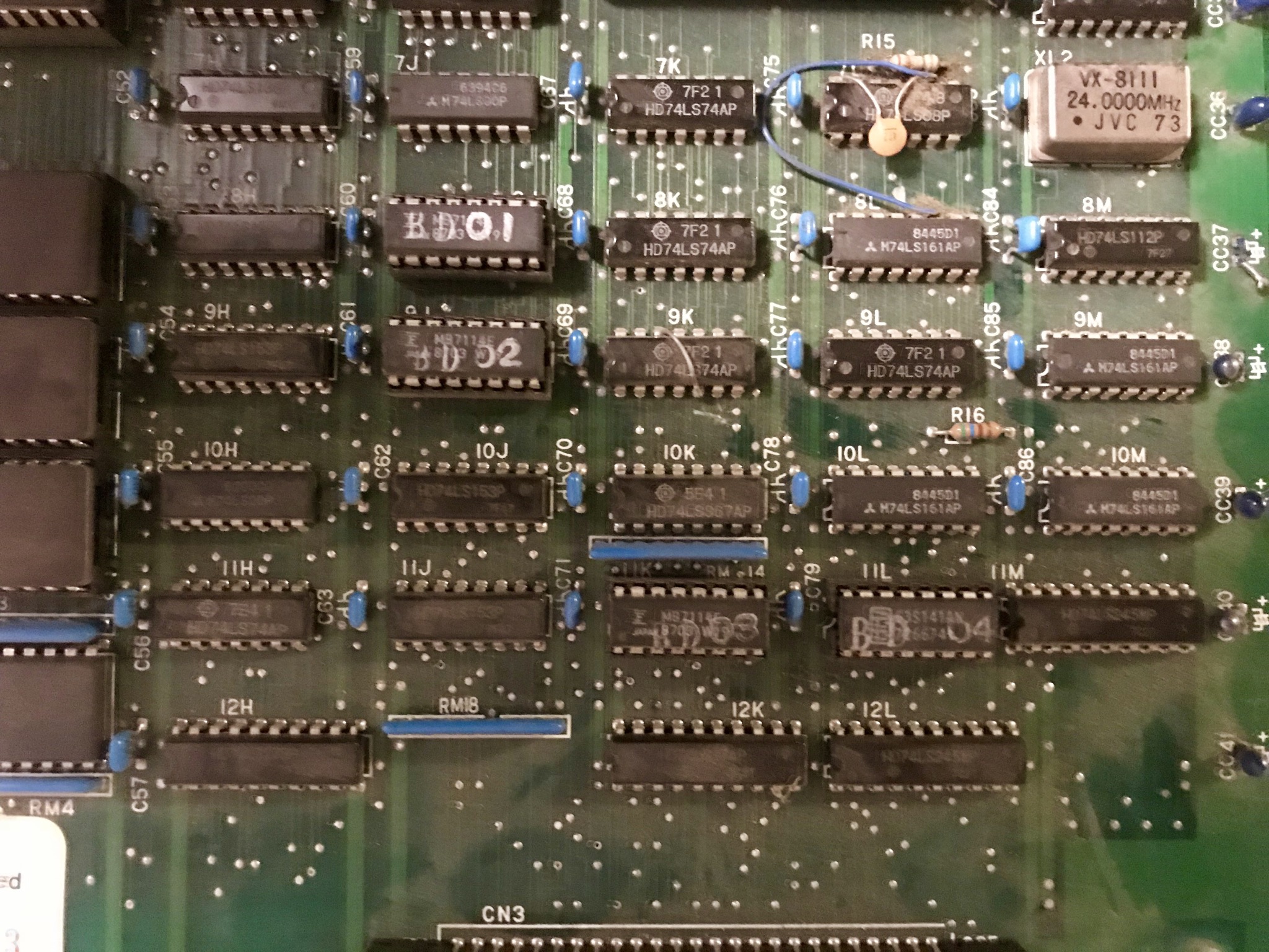

Well, burned @caius 's file, wired 10 to 8, and popped it in.
Now the game gets a title screen and coins up and plays!
But there are awful sync issues, and the video is all scrambled, ha! This is better than before where it didn't do anything.

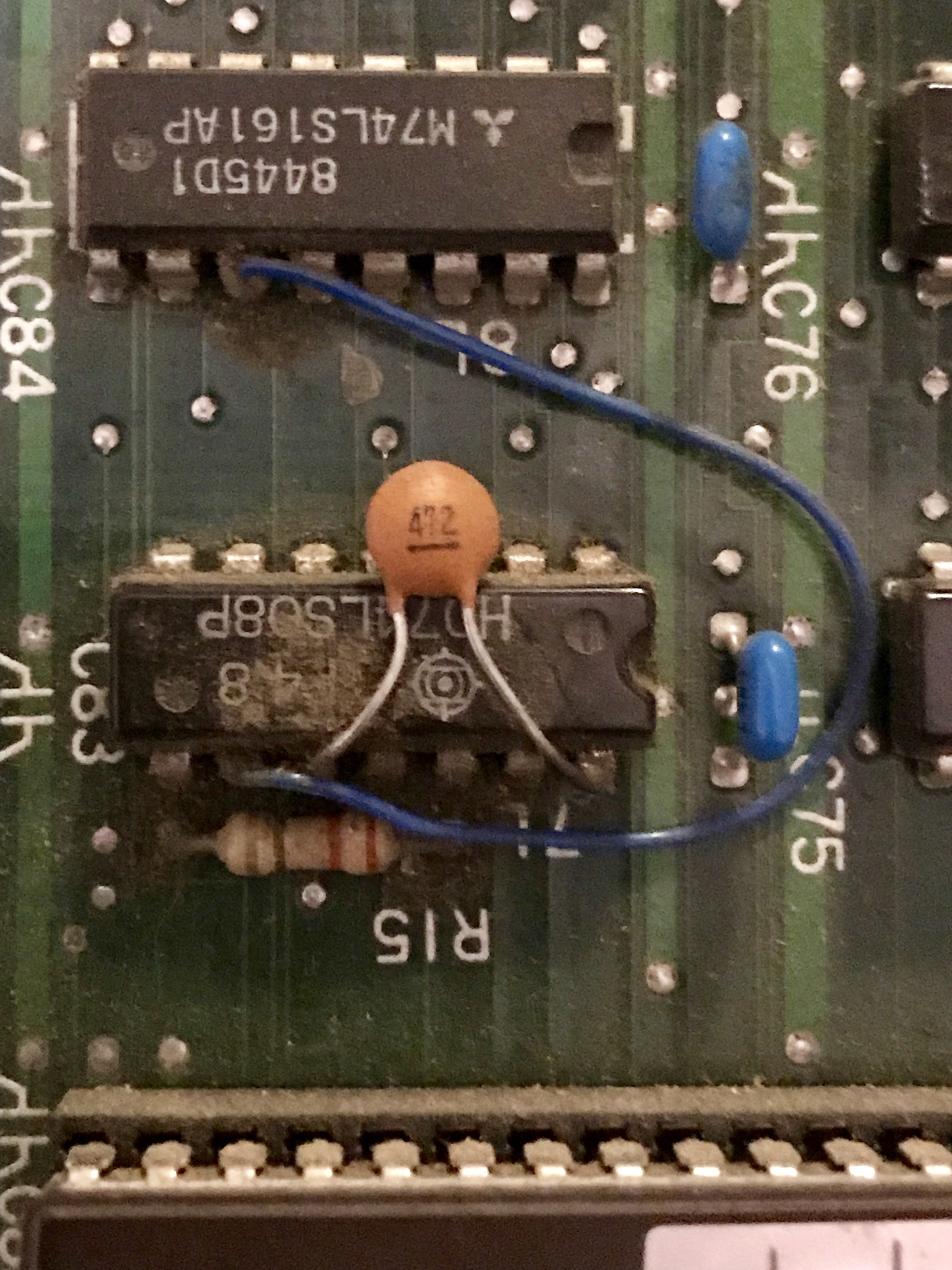

Sync goes to R15, and into pin 8 of 7L, which looks to be replaced. 7L is an HD74LSO8P, it has pin 9 tied to pin 10 of 8L which is a M74LS161AP.

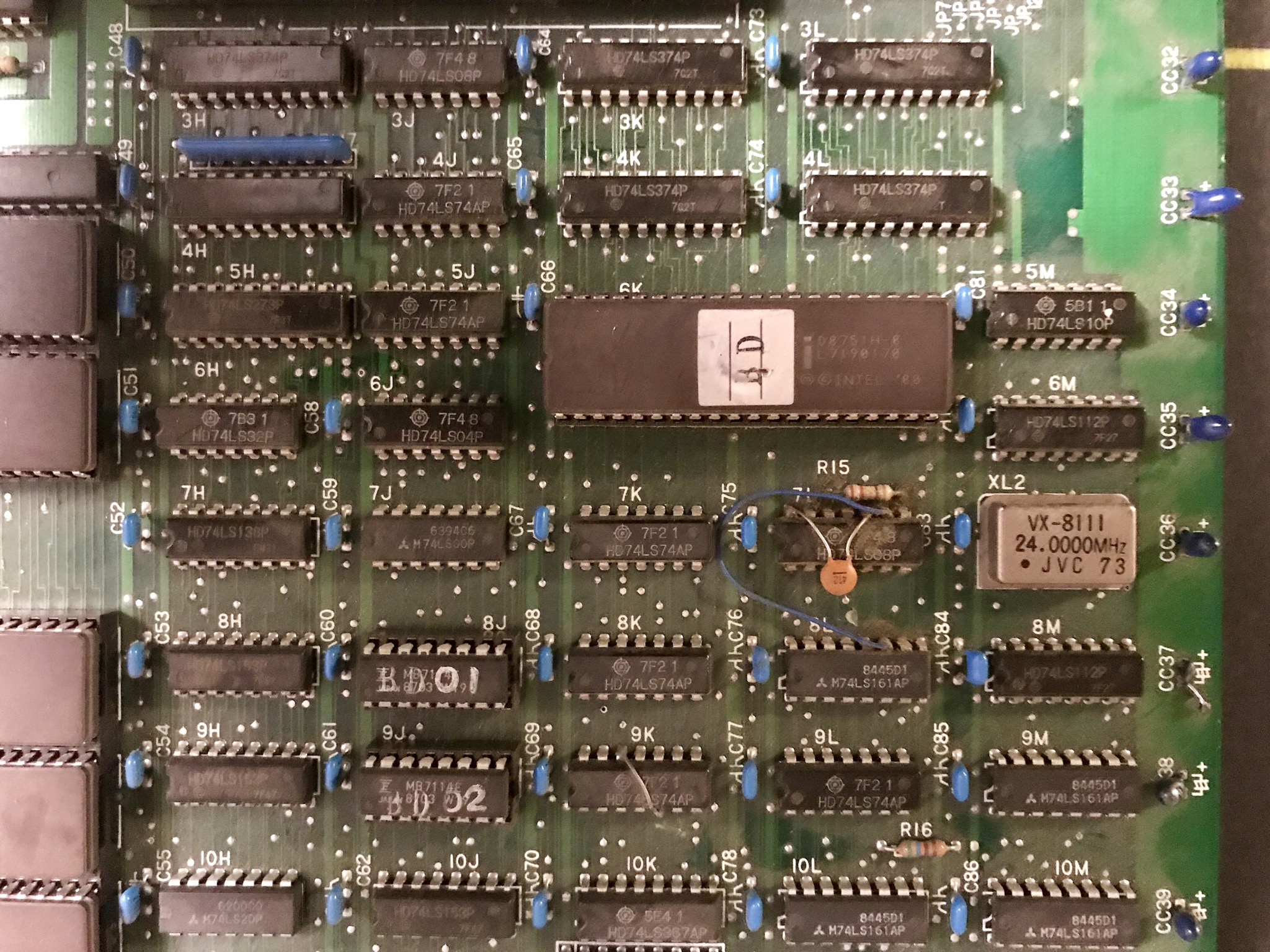

Going to look at @ShootTheCore 's PCB pic and see what's what.
Both PCB's have the same wire between 7L and 8L, but mine does not have the ceramic cap.

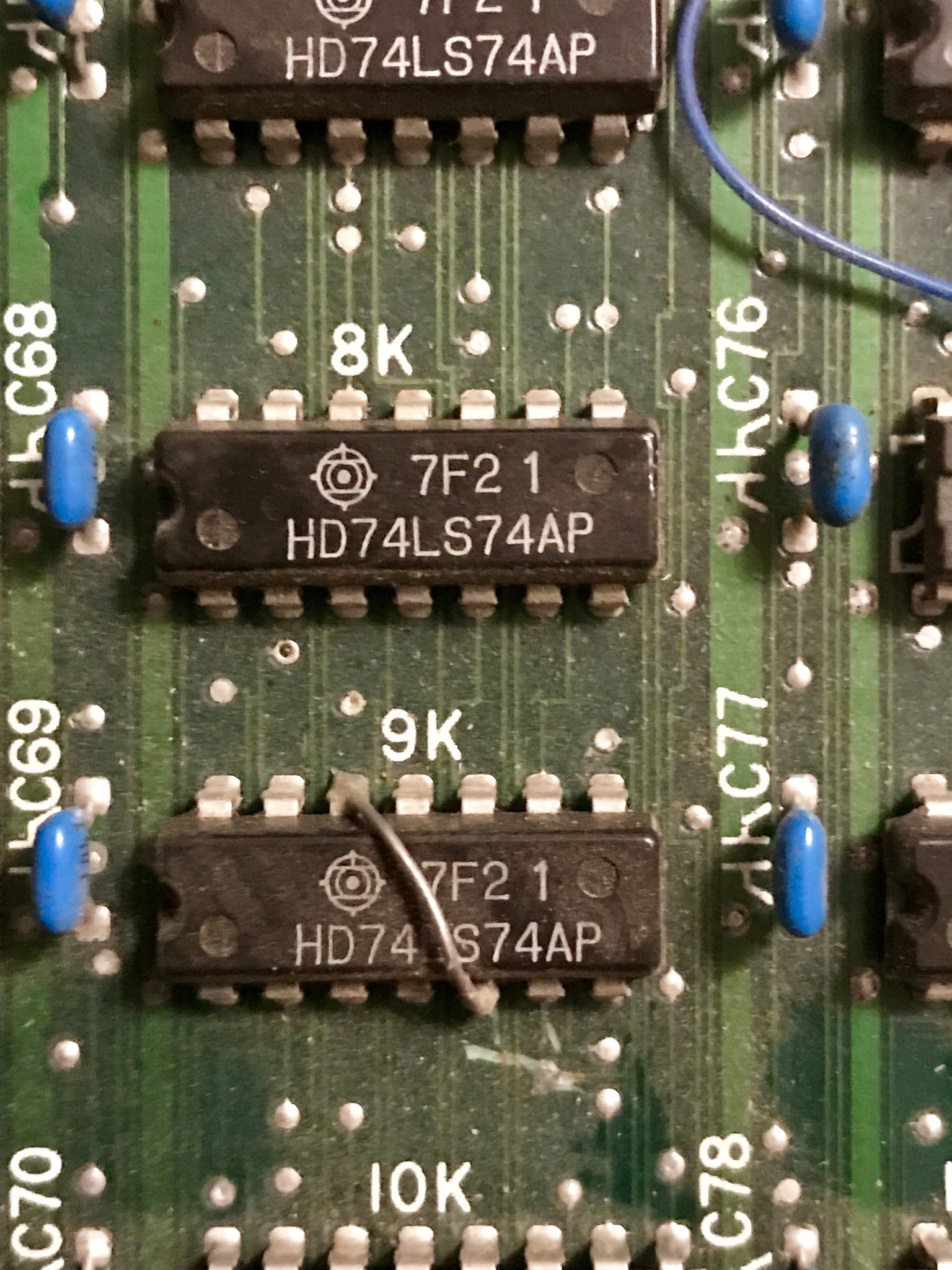

More pics of added caps and jumper wires on my board in case it’s helpful:
These are factory fixes, you can find them on many Capcom boards of same era (Side Arms, Section Z, etc..)
