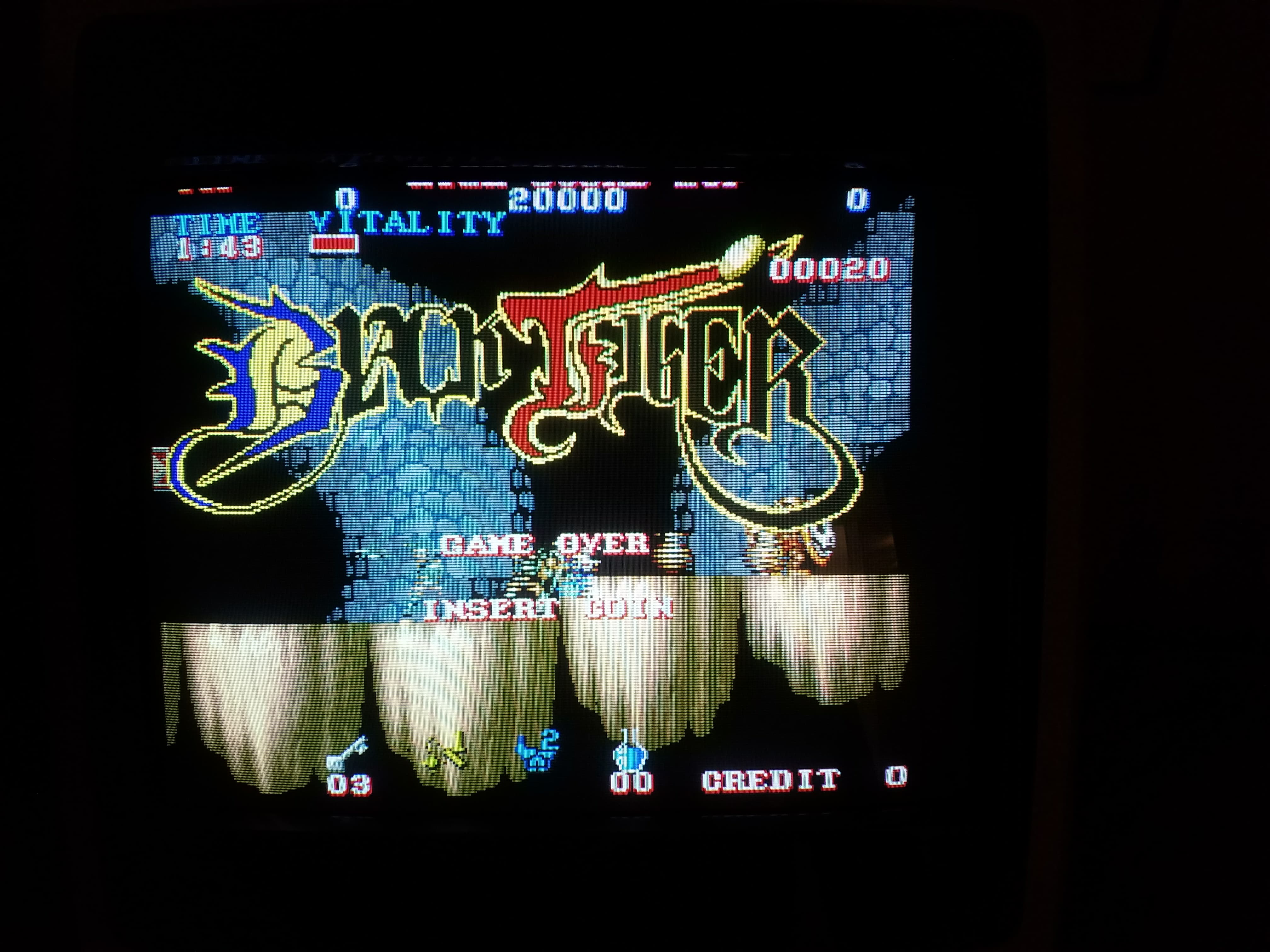

@caius ! That almost entirely fixed it!
Now I'm going to test all the graphics roms against the MAME set and see if they're good.
From there, I'm not wholly sure where to go, but it'll keep me busy for a little while anyhow, haha.
Thank you for all for solving the mysterious missing BD03. Extra thanks to Caius for providing me with the proper file to write!

My ChipMax 2 doesn't read 82S129, or the c8751h-88 apparently. So aside from those I have checked everything and they verify against MAME just fine.
Time to explore a bit with the magnifying lamp.
So I fixed a few cold solder joints, put all the ROMs back in, and noticed two traces cut:
https://imgur.com/L5QrKq1
Fixed that, and now my game is a mess...
https://imgur.com/eYhDJwX
I even tried removing the wires I used to fix the broken traces, and the issue persists..
It was better before I touched it T_T.
Might be time to call it a night.
