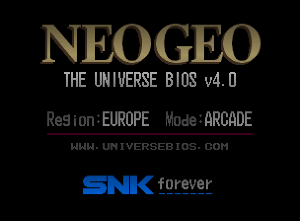

I managed to find the wrong line. The card started up fine, but the sound is bad, but the sound is bad only in the 2nd slot. The sound works flawlessly in slot 1. If both cards are included, the card in the 2nd slot makes small graphic errors. can be seen in the video.
https://youtu.be/v4ZGXRQw4ro

if both cards are included, the bios switches from time to time between 1-2 cards. the sound of the 1 card never deteriorates. even if there is only 1 card in it, only the sound of the 2 cards inserted in the slot is bad. the sound is so bad that certain sounds are distorted and very loud. there are sounds that are quiet and distorted.
sorry I had the volume down on my computer and was only looking at the graphics. It sounds like its playing the right sounds, just distorted. I believe this will point to a PCM data path issue from the carts prog board.
