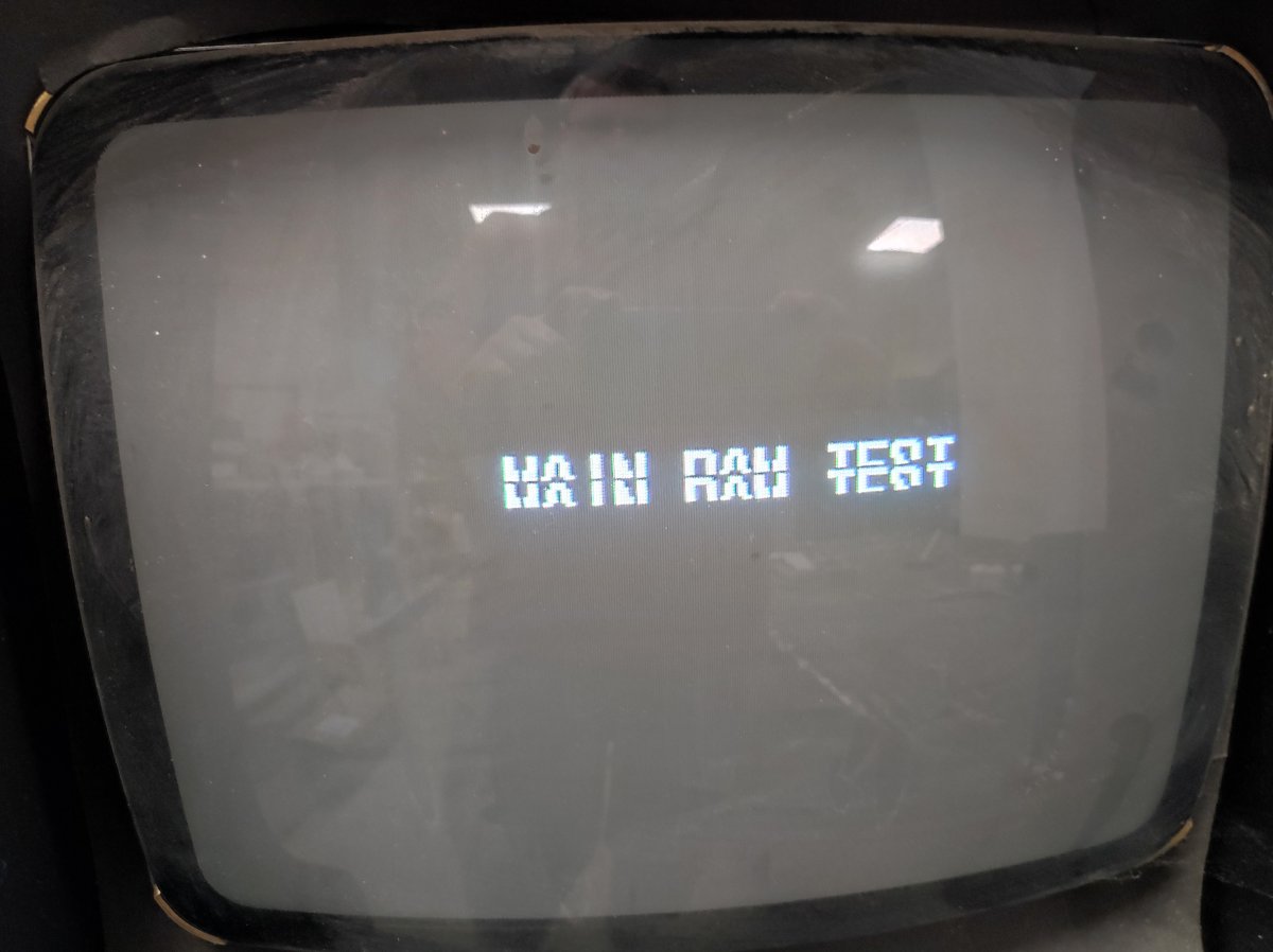

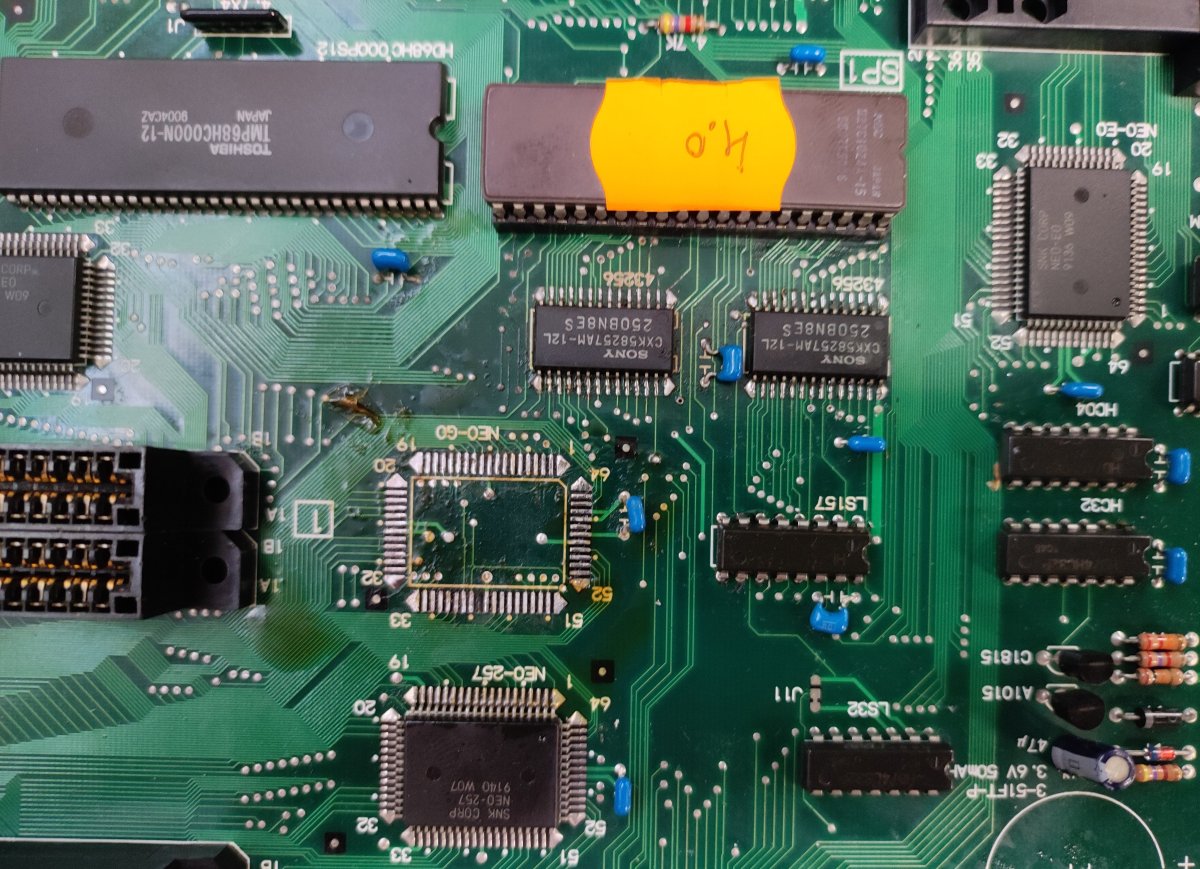

I saw damage to the NEO-G0, so I soldered it off.
NEO-G0 41pin shows damage. does not connect anywhere (41pin)
I did NOT put NEO-G0 back in the sheet. I turned on the board.
The watchdog image has stopped and "MAIN RAM TEST" is displayed.
I put another NEO-G0 back in the board. the watchdog is back.
Will the fault be on this line?

Sounds like that NEO-G0 is getting enabled when it shouldn't be.
https://wiki.neogeodev.org/index.php?title=NEO-G0
If you look at the internal logic section it shows that pins 39 and 51 are what could enable parts of the program rom to pass to the CPU data bus. I would check to see what those pins are doing.
Also, In the lower left of the page it has the pinout for J4 on MV2B which should be the same as MV2F. In the comments for that it gives the impression those enable pins come from the NEO-I0 chip.
Your MAIN RAM TEST likely just means you have all your hard dips in the ON position. You also seem to have a 32K/slow vram related issue given the dupe/corrupt text.
I followed the line between NEO-G0 pin 39-51 and NEO-I0. NEO-G0 pin 39 goes to NEO-I0 pin28.
NEO-G0 pin 51 goes to NEO-I0 pin27.
That's why I replaced the NEO-I0.
