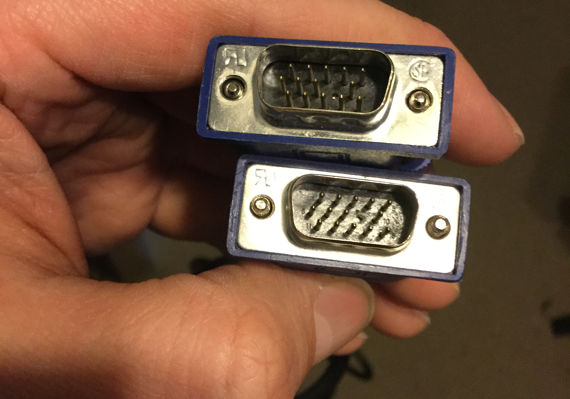

Pin 9 on the Naomi's VGA out will provide 5v. It's meant for amplifying the video output if necessary. It shouldn't short anything AFAIK.
Unfortunately the engineer might be wrong this time, I have run Naomi 1 using a VGA cable on an LCD AOC monitor. Runs fine.

My naomi original cables was without pin 9.

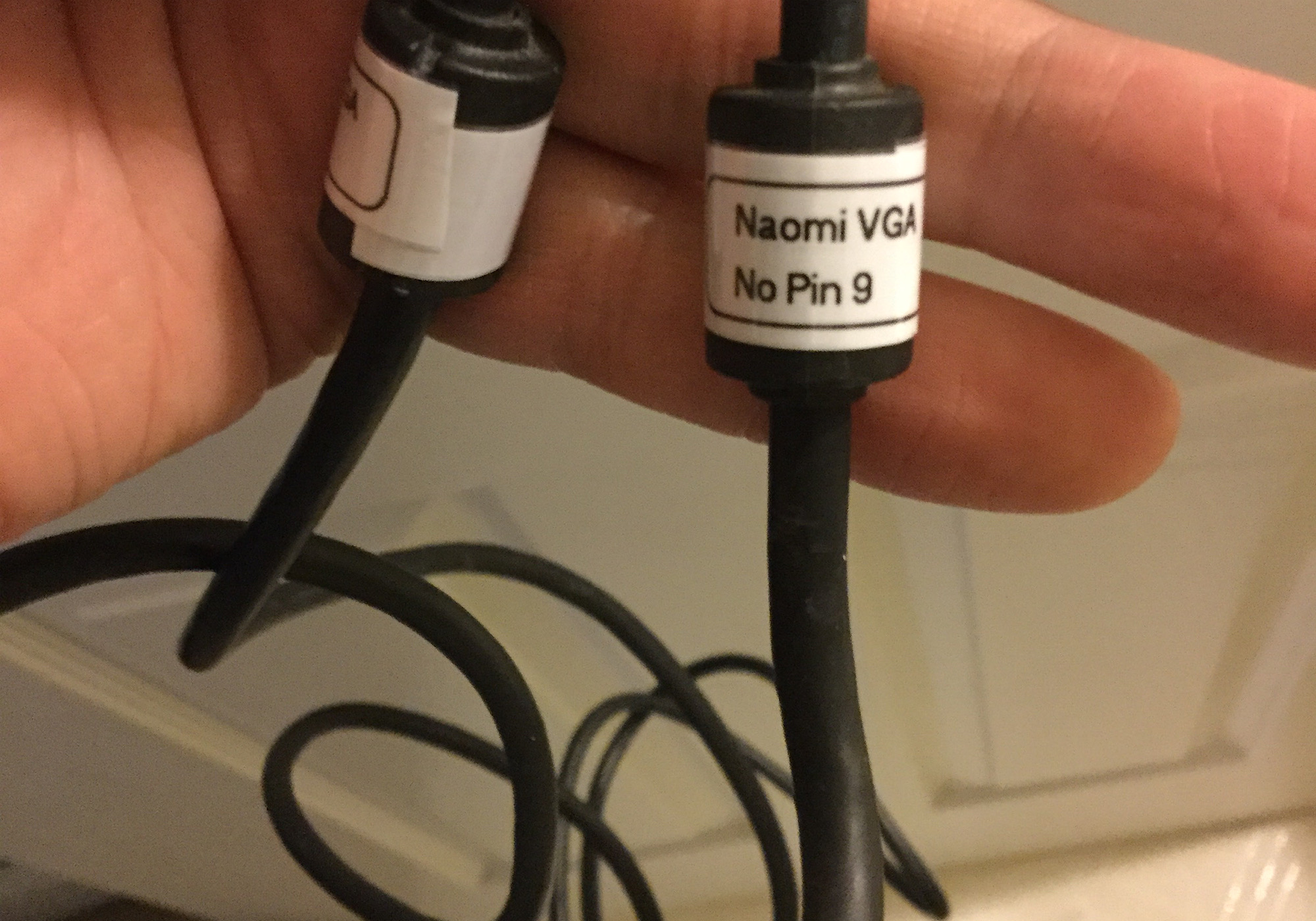

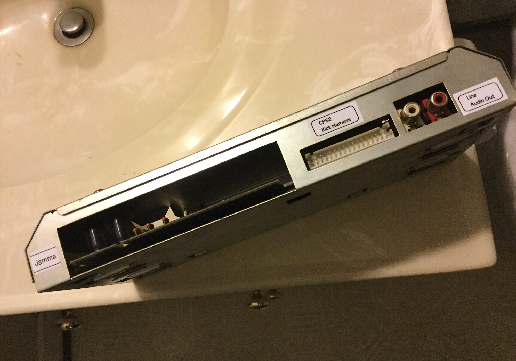

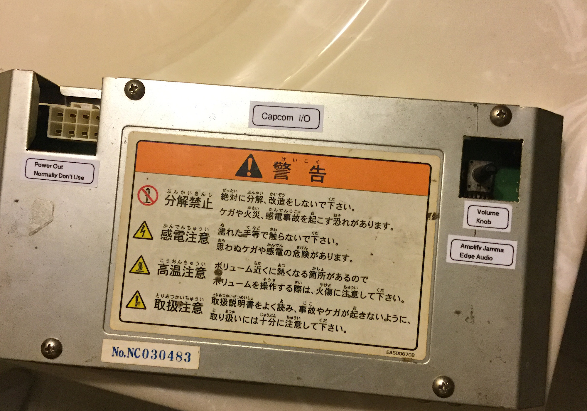

Whelp here I am pulling pins from cables. Don’t forget to label shit kids. I just labeled the heck out of my Capcom I/o too. Label everything.

yeah label maker all day. I go through so many tapes it’s ridiculous.

anyone know if i should be able to run 31hz through the jamma edge on a nanao 2930 using a capcom I/O? Or do I need to go straight from the naomi into the db15 connector on the monitor, now of course with pin 9 out of the equation on the cable. I have 2 naomis, so if I fried one I can try the other. Hopefully i didn't fry it though because it was a 2 and i eventually want to hook up a wheel and pedals for some initial D. I even got card readers and new cards so need to figure out how to connect that crap too. should be fun.
There's a switch on Capcom I/O, but you can do directly from Naomi too.
holy crap i didn't see those dips on the capcom i/o. one has csync or h/v sync. the other has 4p 4 shot or 2p 6 shot. that must be for the cps2 kick harness. cool stuff, learn something new every day. time for more labels. Also has a test button. Is that the same as hitting test on the jamma?

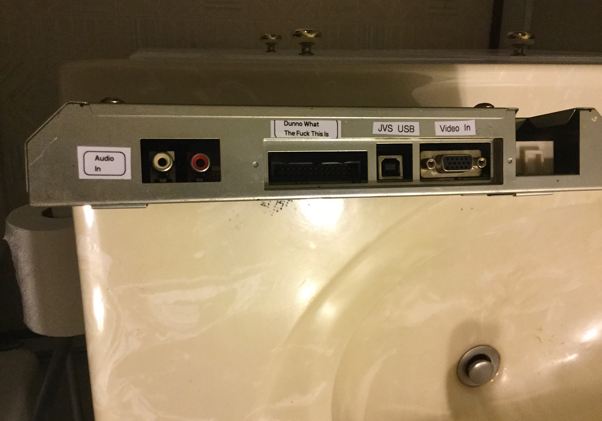

now i might as well complete this labeling. what is the connector to the left of the JVS USB?

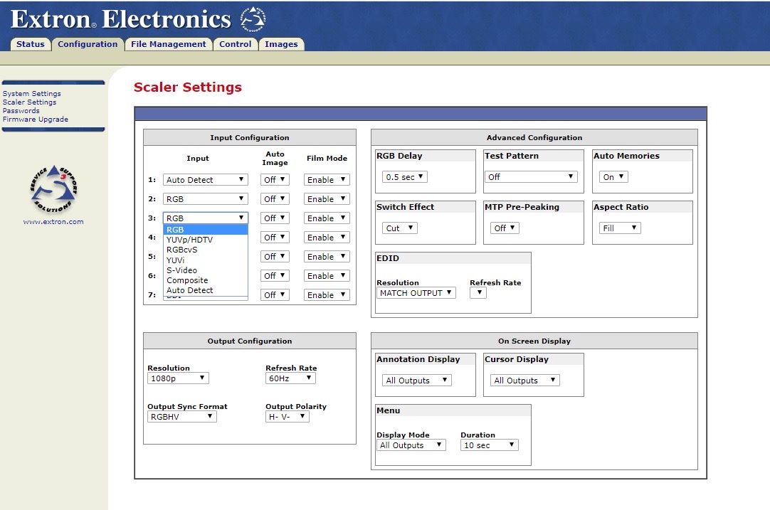

I'm assuming this thing will take the input through de15. the one I have has DVI-D output where the one in their picture just has a blank plate there. So far I've just connected 1080p crap like a ps4 and a PC. I intend to try something composite and s-video to check out the upscaling and see how it performs. even if it is crap, the annotator function is fun. passing 1080p through it looks great and doesn't seem to add much lag. Gives me an excuse to test this thing with something lower res. Looks like input 3 is a beast and accepts all sorts of things. This is the web interface for the annotator. Extron units with a web interface are great.

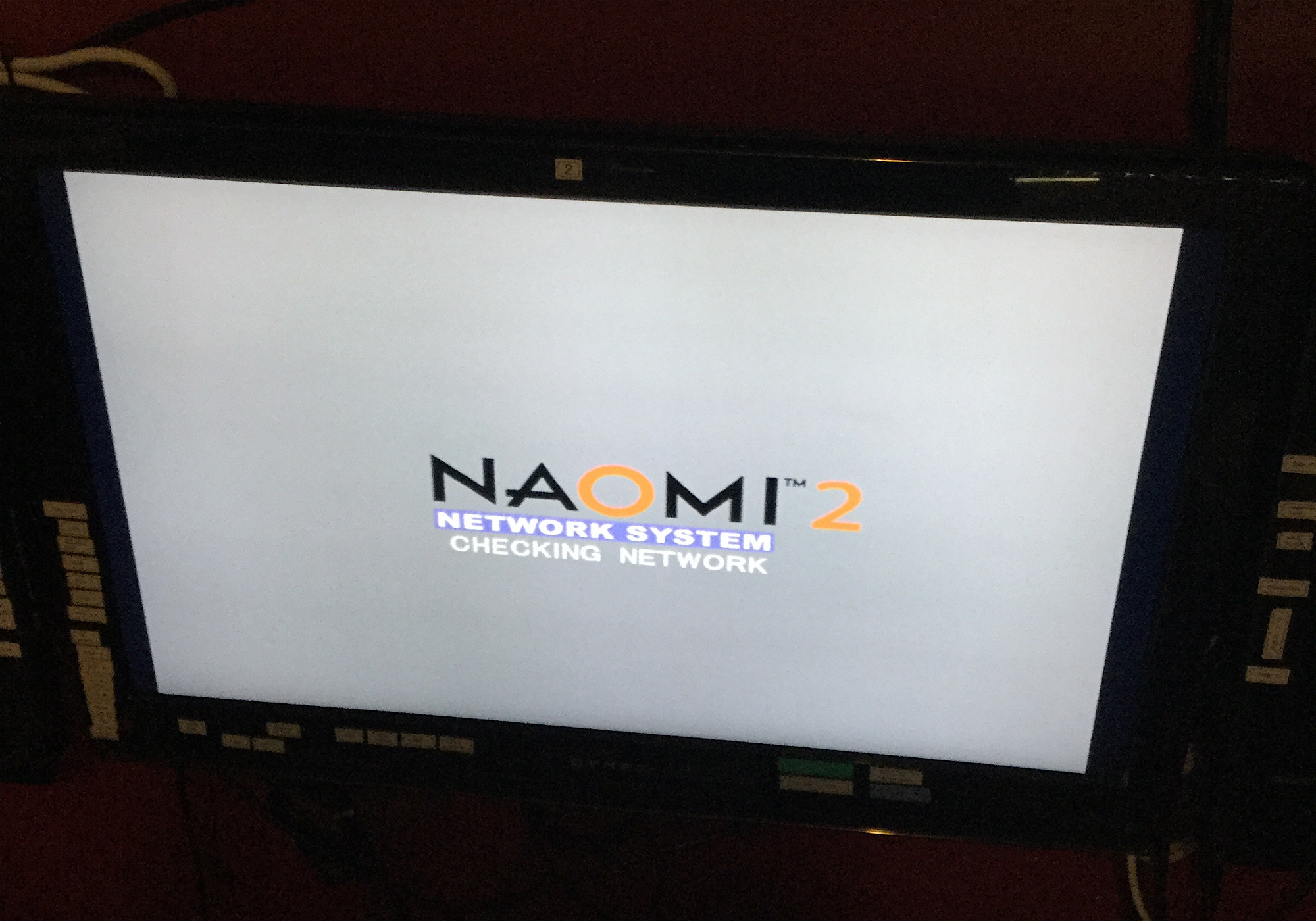

First test. Vga cable missing pin 9 to dynex tv. Video works, so thankfully I have not ruined my Naomi, at least it appears ok. Connected pi and the Naomi to a little network switch and I tried loading a game using the pi force web or whatever it is called. It just gets stuck loading so I’m not sure what is wrong. I might need to do some configuration but I think I’m close. Would be really cool to see a game boot on this thing.

hmm, still getting stuck in “now loading”. Video works 15hz on my blast cab.
