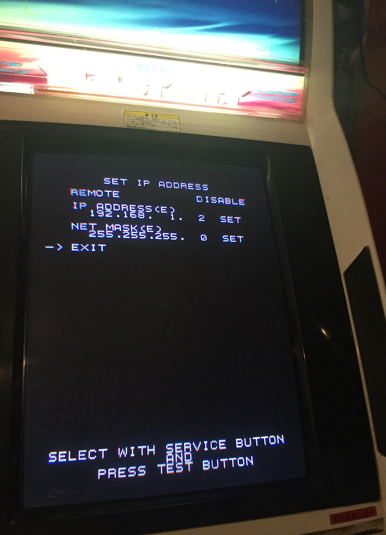

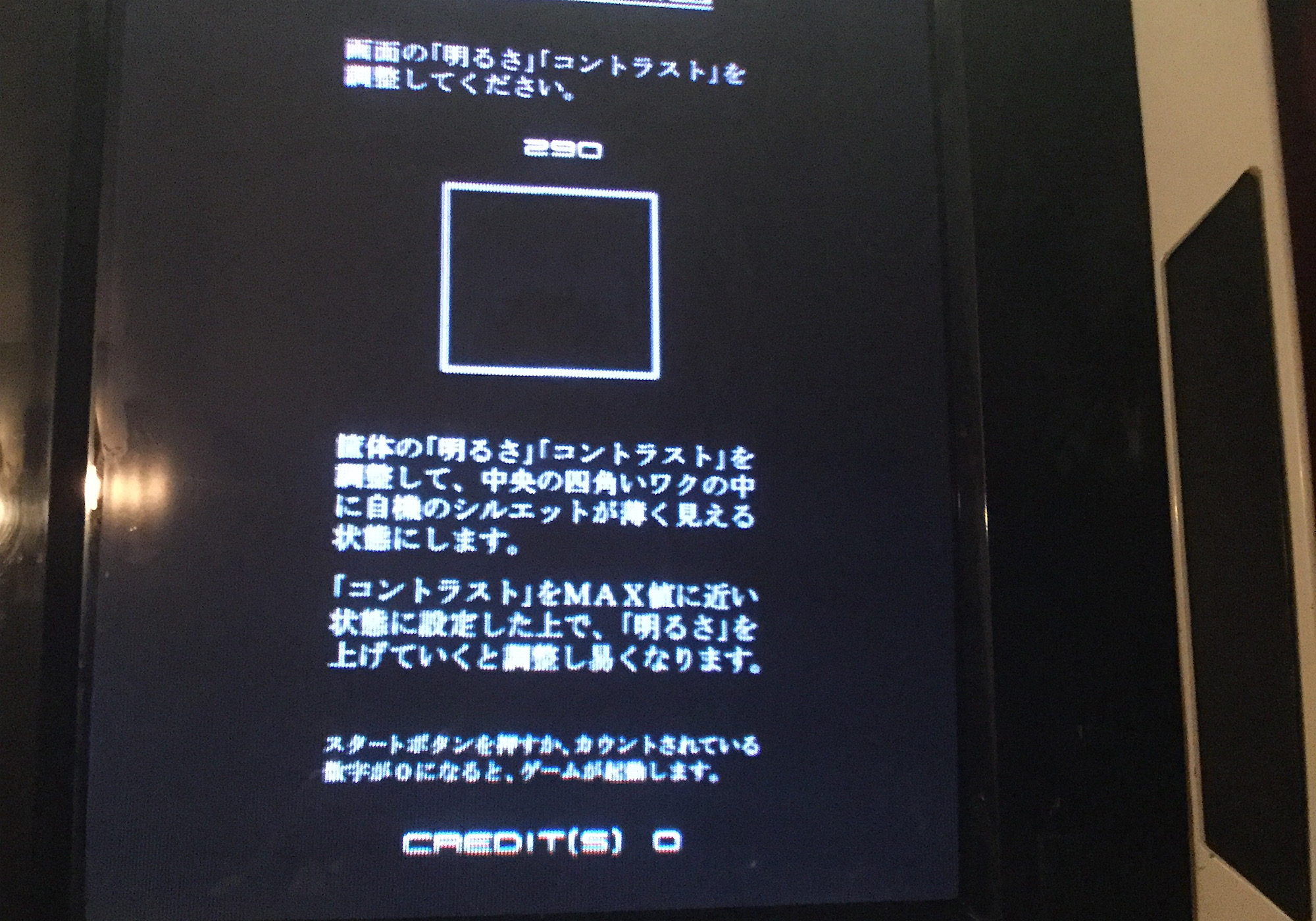

ok set IP address to 192.169.1.2 and tried ikaruga. Thought I had it but I get this screen that is counting down from 300. What is this? If I credit the credit counter doesn’t go up. I can’t seem to do anything.

After that long countdown it booted but I can’t credit. I think I might be having deja vu.

this look right? I don’t see a place to set gateway

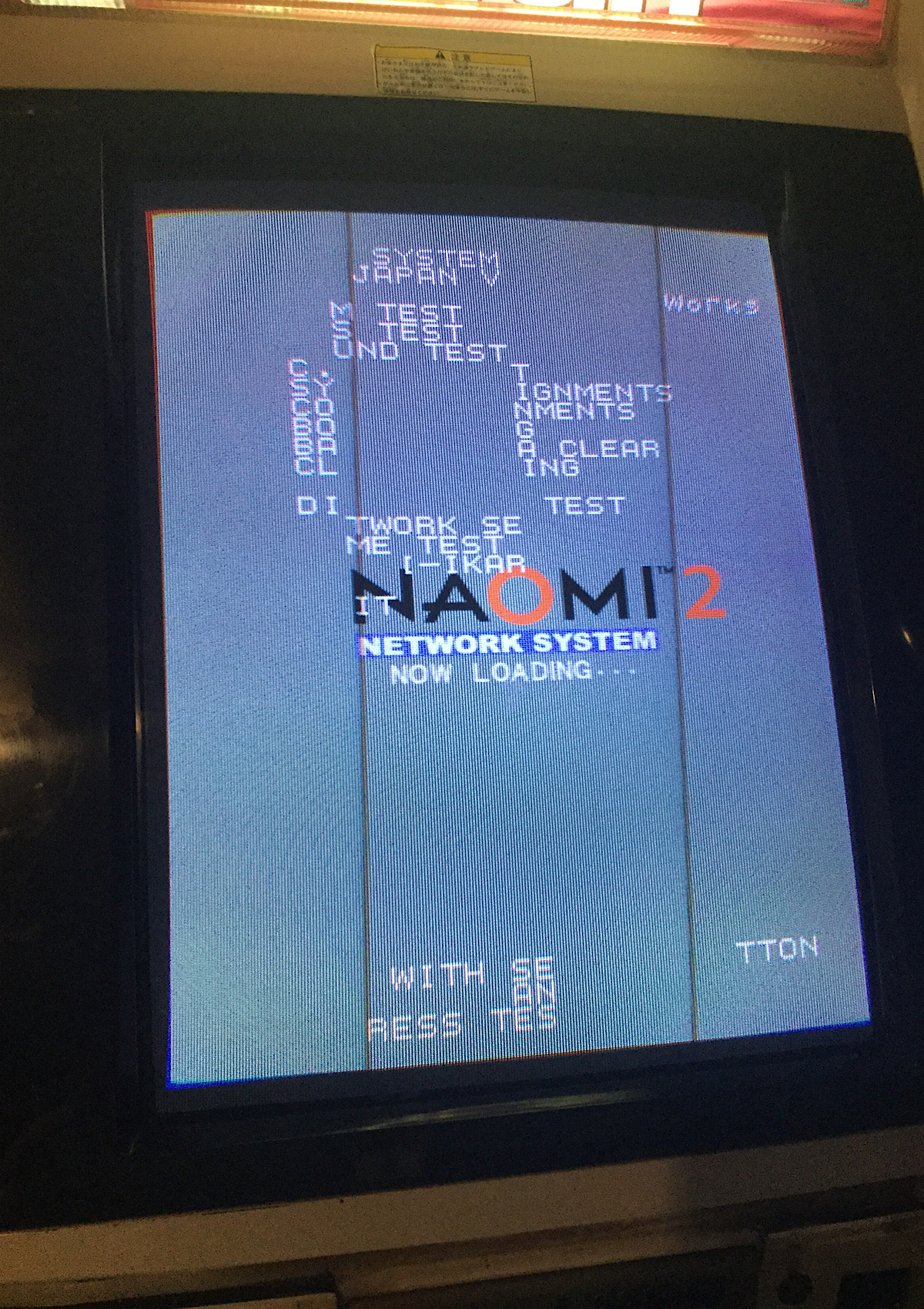

oh man this is fun. No idea what the hell is happening

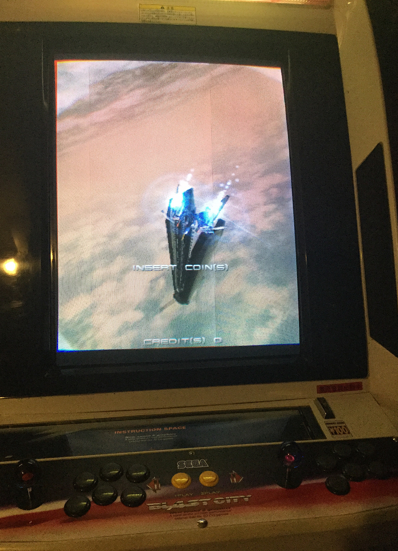

Got tired of messing with the Naomi 2. I think maybe the netdimm doesn’t make a great connection with the main board and I don’t know where the screws are. Who knows. I swapped in a Naomi 1 and it works. I can credit and play ikaruga. I still don’t have perfect sync on the blast city. I’m assuming I need to fiddle with a knob on the back to get it to hold.
Screen is asking you to adjust brightness and contrast until you can just see a silhouette I'm the box.
thanks dude! I love this forum!
