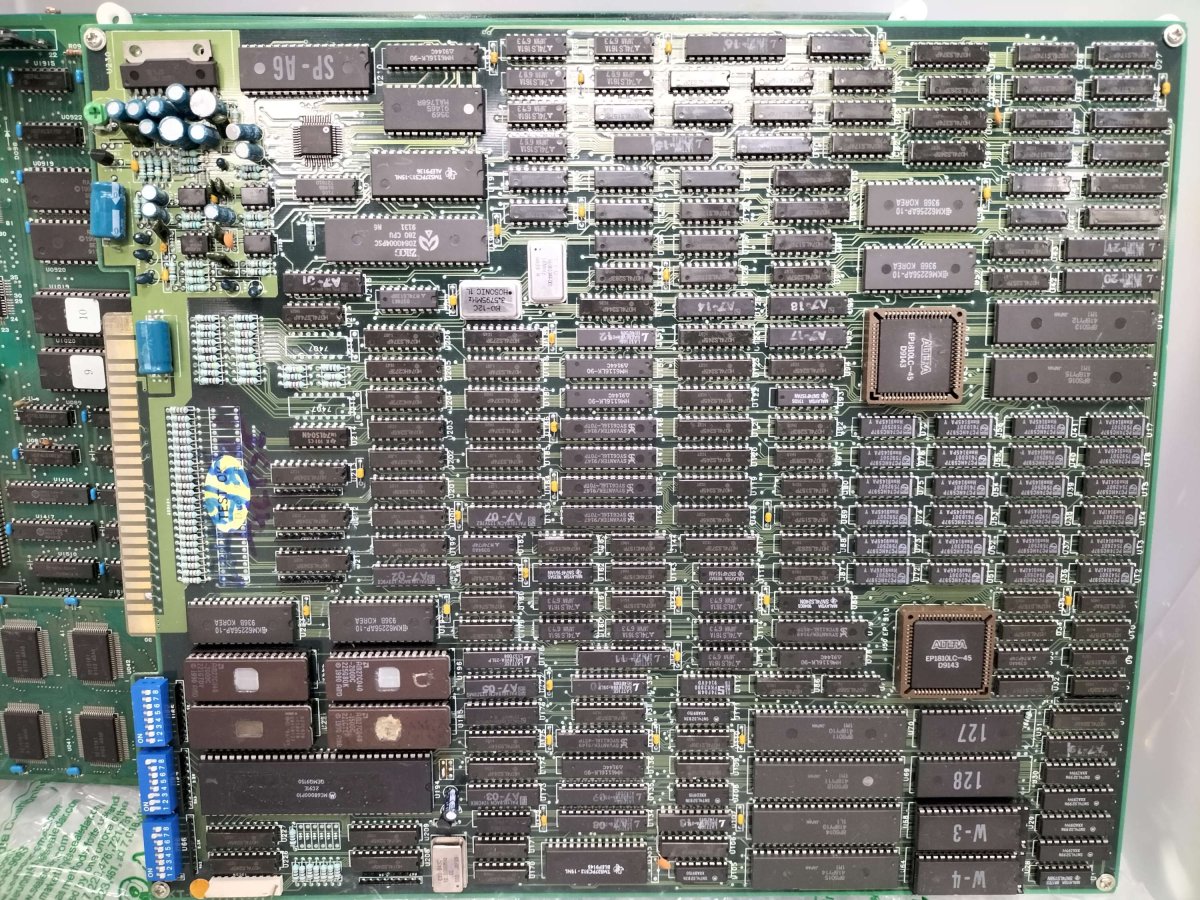

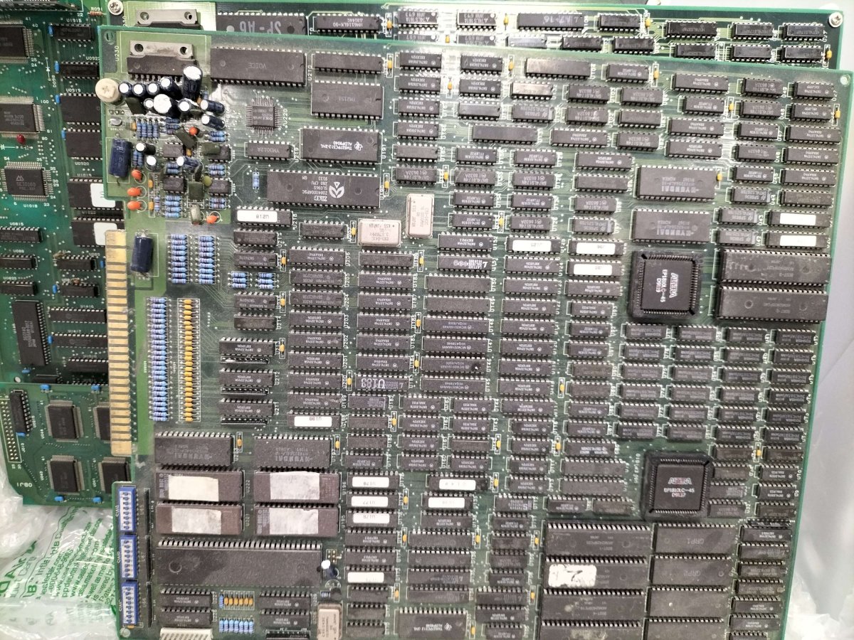

Finally got some pics, I've got two of these boards with the 4 roms direct on the board by the 68000

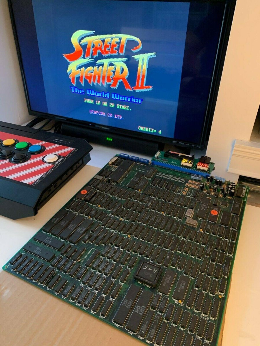

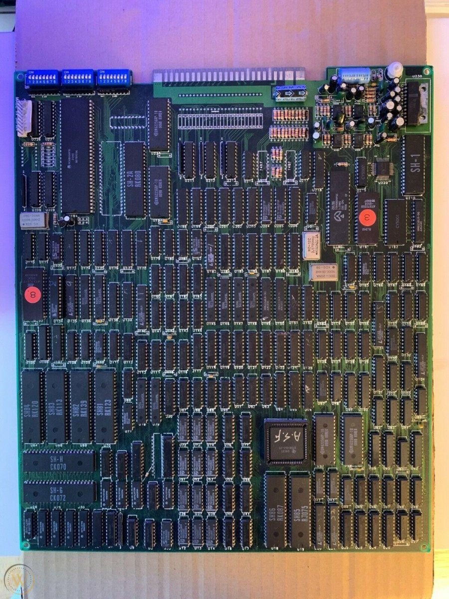

I changed the sub-board ROM socket a while back into a turn pin so I could still keep trying the 4 x ROM sub board but also throw a 27c800 in the socket. I noticed a board for sale on Worthpoint a while back and someone else earlier linked to this image which is my board with a single main CPU ROM! (see pics last one is mine).

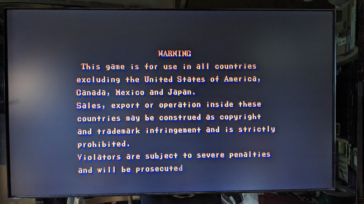

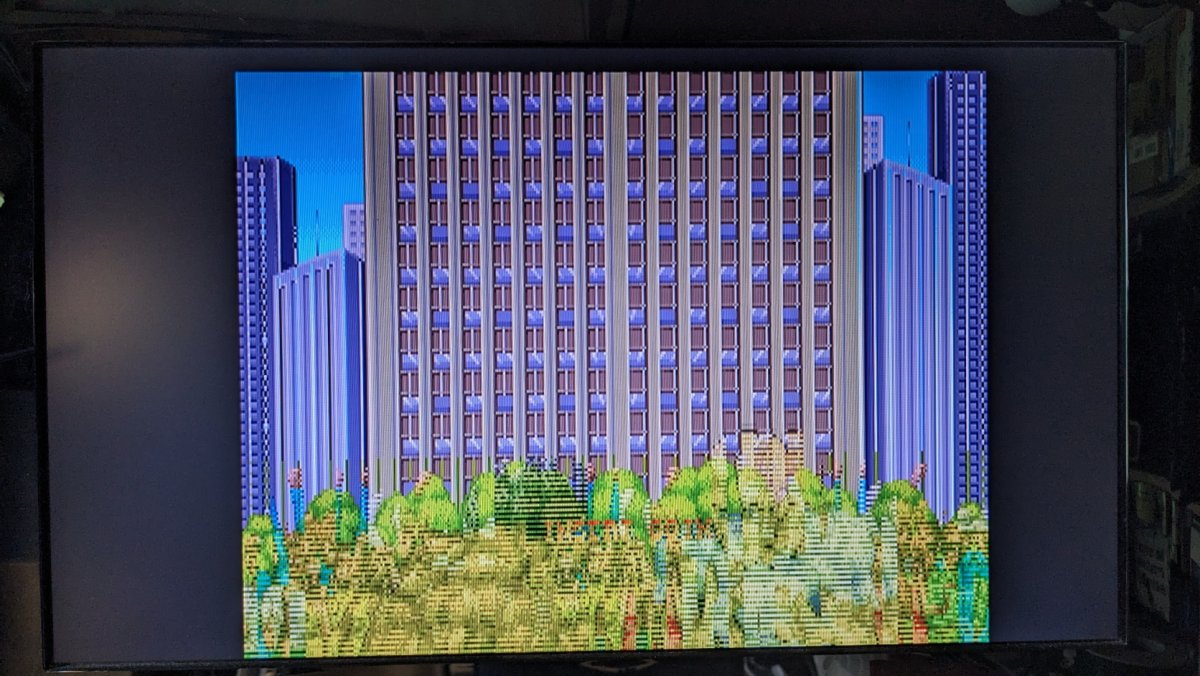

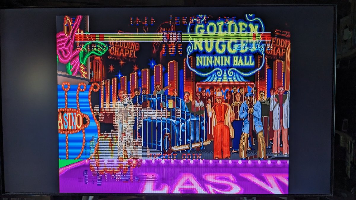

Finally this board is up and running. A good learning exercise so thanks to all who contributed and a special mention to Hammy who's patience I truly tried!
So as mentioned slipping whilst testing I ended up burning some PALs: U104, U135 and U151. It turns out U151 is clock dividing 16mhz down to 4mhz and suppling this x 4 to the graphics PLCC.
The fried trace which I whiffed burning when I shorting the pins but couldn't find was coming out from under the U68 sprite ROM and going to PAL U107 and logic ic U1
The ROM set is the L735 test ROM although the board could probably run others but lets not run before we can walk!
I still have horizontal lines through sprites and some vertical lines but hopefully that's just a simple RAM swap.
Sure this board is a bootleg and many would question working on it but this exercise was only ever about learning some stuff about arcade boards on a budget and since starting this board I've repaired others and learned a lot.
The soldering skills are now night and day also now which helps.
Maybe this thread will help someone else?
